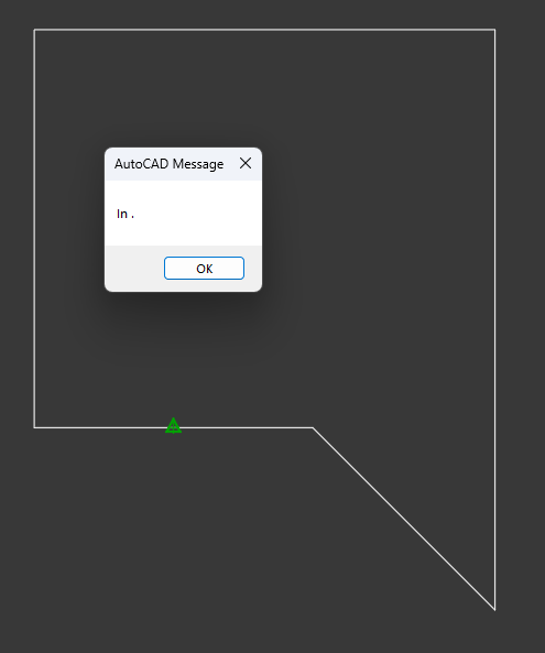

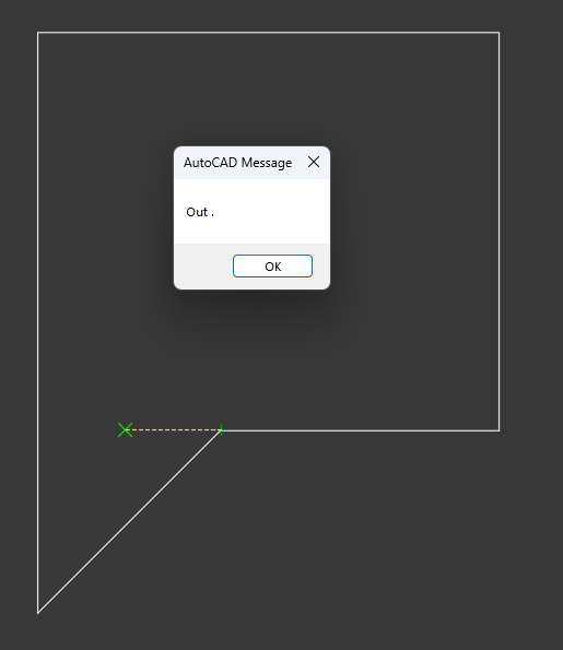

It's more in how the code has been written. You've set p2 to be the polar of pt at 0 degrees. So if there's no curve along that direction, ssget cannot find any curve and returns nil, thus ssname then yields an error.
I would do it this way:
(defun pt-in-region (pt pts Acc / ss-member-pts pt1 ptn p at ACC AT P PT PT1 PTN PTS)
  ;;judge a point is in the 2D polygon , polygon given with vetexs .
  ;;by GSLS(SS) 2011.03.28
  ;;return 0 at polygon, 1 in it, -1 out it .
  (defun ss-member-pts (pt ptl acc / is_go i len a b)
    (setq is_go	T i 0  len(length ptl))
    (while (and is_go (< i len))
      (setq a(car ptl)ptl(cdr ptl)i(1+ i))
      (if (and a (equal a pt acc))
	(setq is_go nil  b (cons a ptl)))))
  (setq pt1(list (+ (car (apply (function mapcar) (cons (function max) pts)))(abs acc)(abs acc))(cadr pt)))
  (mapcar(function(lambda (x y)
		    (if(setq p (inters pt pt1 x y T))
		      (progn (if(equal (+(distance pt x)(distance pt y))(distance x y)acc)(setq at T))
			(if(not (ss-member-pts p pts acc)) (setq ptn (cons p ptn)))))))
	 (cons (last pts) pts) pts)
  (cond	(at 0)
	((and (not at) ptn)
	 (if (= (rem (length ptn) 2) 1)
	   1  -1 ))
	(t -1)
;;pts pt is
(defun c:test (/ is poly pt pts)
    (setq pt   (getpoint)
          poly (ssget "f" (list pt (polar pt 0 10000)) '((0 . "LWPOLYLINE")))
    (cond
        ((not poly) (alert "Out ."))
        (t
            (setq
                pts (mapcar 'cdr
                        (vl-remove-if-not
                            '(lambda (x) (= (car x) 10))
                            (entget (ssname poly 0))
                is  (pt-in-region pt pts 1e-8)
            (cond
                ((= is -1) (alert "Out ."))
                ((= is 0) (alert "At ."))
                ((= is 1) (alert "In ."))
That being said, your code still yields incorrect results sometimes... That's if there is a horizontal segment along the polyline? I guess it's just up to the function itself:
