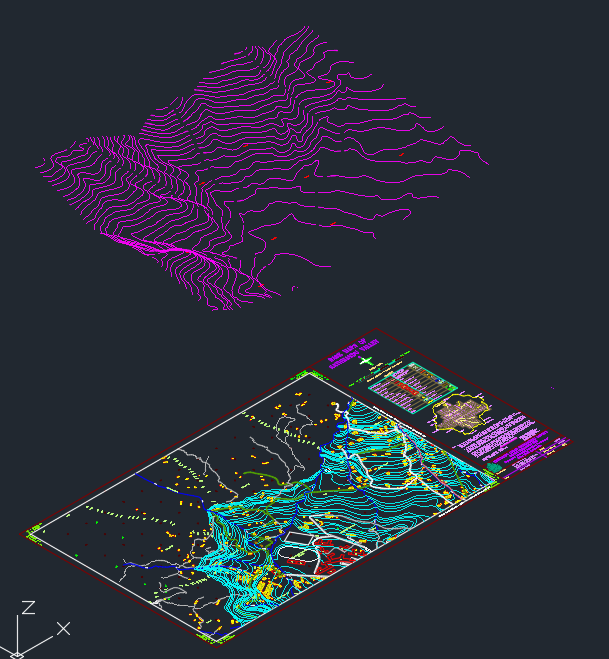

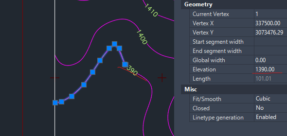

  3. I used a similar approach here, the user wanted to set the elevation of the contour lines to the nearest label. This is where KD-Trees really start to shine as they can handle millions of points, with millions of searches

  5. Yeah, I chose to search for the closest polyline to the text. BricsCAD has ssget crossing circle , (ssget "CC" point1 point2), could be similar to a radius search. Caveat, you’d have to call ssget for every mtext There’s a .DWG in the original post in the lisp forums
  6. Just a comment done a lot of find object next to text, just used get text insertion point, then use "ssget "F" pts" the pts are say 10 points made via a polar defun looking like a circle . I noticed you go the other way around looking around the pline for the text. Would be good to get a true sample dwg.
  7. Yep, easier too, since there would be not need to format the string for MText. Even though Python has robust string operations, it’s still weird to get it perfect https://docs.python.org/3/library/string.html I was just following along the original sample. The part I wanted to illustrate was, using a hashmap for mapping points to objects, and using the KD-Tree to do the spatial search I wrote the same KD-Tree and map for AutoLISP, I’m just really bad at lisp, so it’s hard for me to make samples lol https://github.com/CEXT-Dan/ads_geo
