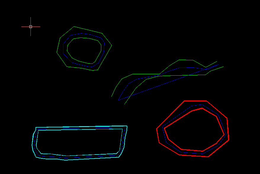

Select both polylines find the polyline that has the most vertex Then process those vertex with vlax-curve-getClosestPointTo store the mid point of vertex and closest point in a list entmake new polyline with list points. Seems to work well tho will need to test if you have open or closed polylines. defaults to closed tho i don't think its quite the mid / avg path ;;----------------------------------------------------------------------------;; ;; CLOSE POLY AVERAGE, Finds the mid point avg between close polylines donut shape (defun c:CLOSEPOLYAVG (/ sel1 sel2 ent1 ent2 cnt1 cnt2 main other i ptv ptc mid pts) (defun c:CPA () (C:CLOSEPOLYAVG)) (defun midpt (p1 p2) (mapcar '(lambda (a b) (/ (+ a b) 2.0)) p1 p2) ) (setq sel1 (entsel "\nSelect First close Polyline: ")) (setq sel2 (entsel "\nSelect Second closed Polyline: ")) (if (and sel1 sel2) (progn (setq ent1 (vlax-ename->vla-object (car sel1)) ent2 (vlax-ename->vla-object (car sel2)) cnt1 (fix (vlax-curve-getEndParam ent1)) cnt2 (fix (vlax-curve-getEndParam ent2)) ) (if (> cnt1 cnt2) (setq main ent1 other ent2) (setq main ent2 other ent1) ) (setq pts '()) (setq i 0) (while (<= i (fix (vlax-curve-getEndParam main))) (setq ptv (vlax-curve-getPointAtParam main i)) (setq ptc (vlax-curve-getClosestPointTo other ptv)) (setq mid (midpt ptv ptc)) (setq pts (append pts (list mid))) (setq i (1+ i)) ) (entmake (append (list '(0 . "LWPOLYLINE") '(100 . "AcDbEntity") '(100 . "AcDbPolyline") (cons 90 (length pts)) '(70 . 1) ;; closed ) (mapcar '(lambda (p) (cons 10 p)) pts) ) ) (princ "\nNew midpoint polyline created.") ) (princ "\nSelection error.") ) (princ) )
@pkenewell Thank you very much. I finally got it working. In my case, I set the "length of arcs" to 1. And it worked. But I think the resulting axis isn't very geometrically rigorous. I've attached an example image: -The polyline created by the command is shown in green. -The correct geometry of the axis is shown in dashed red. I think there should be a more geometrically rigorous solution in some older Lisp. Is it possible? Does anyone know of one?

The "MC" command by roy437 works for me on your example drawing. You have to set the point resolution (prompt for "Specify Length for arc(ds)") to improve the results. I used 0.1 for pretty good results.
The code does not work correctly with polylines that have a large number of segments. Example1.dwg
I attach an example Example.dwg
@pkenewell Thanks for help. I downloaded the latest code from link and loaded it, but it doesn't seem to do anything. I probably don't understand how it works.
@NikonThanks for the code. I tried it. But it only works sometimes. And if the polylines' first point coincides with the last, it doesn't work. Is it possible that I'm doing something wrong?

Perhaps the most appropriate description is to obtain the axis between 2 irregular polylines
