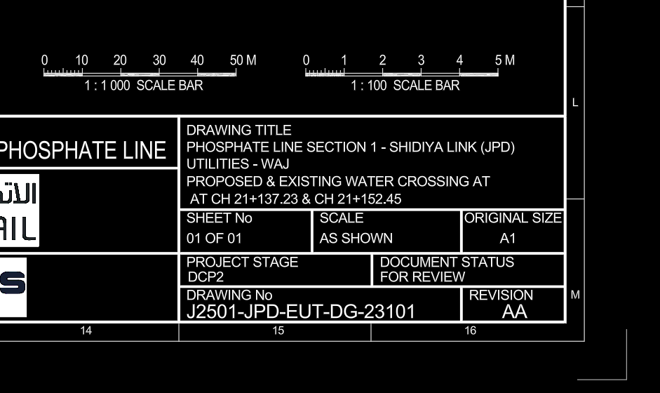

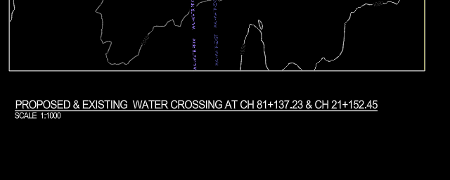

ABOVE IS NAME FOR LAYOUT IN FRAME DRAWINGS TITEL I WANT TO MAKE THESE FIELD WHEN CHANE THE LAYOUT NAME AUTOMATIC CHAHNGE IN FRAME

If I understand the question, you want to use the stationing as part of a text label and as part of a title block. One way to do that is to define a custom property as one of your drawing properties. Set it to that text. Include the field in your text and in your title block. When you change the property, the field automatically updates with the new value.
