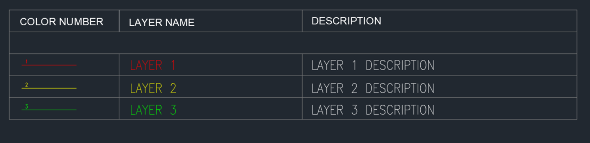

I used THIS lisp pbe to create the layers from excel table. However, I need to create a table inside AutoCAD. Not an AutoCAD table but table consisting of lines and text. Currently I'm doing this manually and I think this can be automated since all the info are already inside. It Will be something like the image below. The Line in the first column resides on it's Layer Name and the number above the Line is the Layer Color. The Layer descriptions are already in the layer manager as well. I attached the file as reference. TEST.dwg
