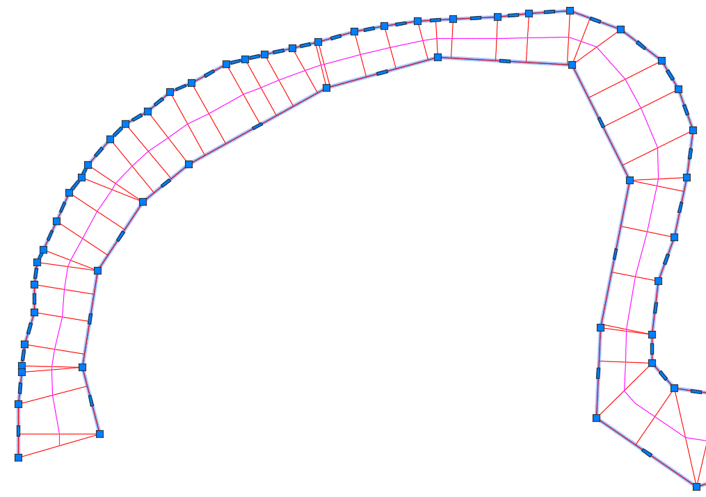

Can you post a drawing with your manual center line? I always pick in the same direction, never noticed the line was different if selection reversed, I'll see if I can find out why. Your examples are much more extreme than anything I would have, could you say what those are and how they are generated?

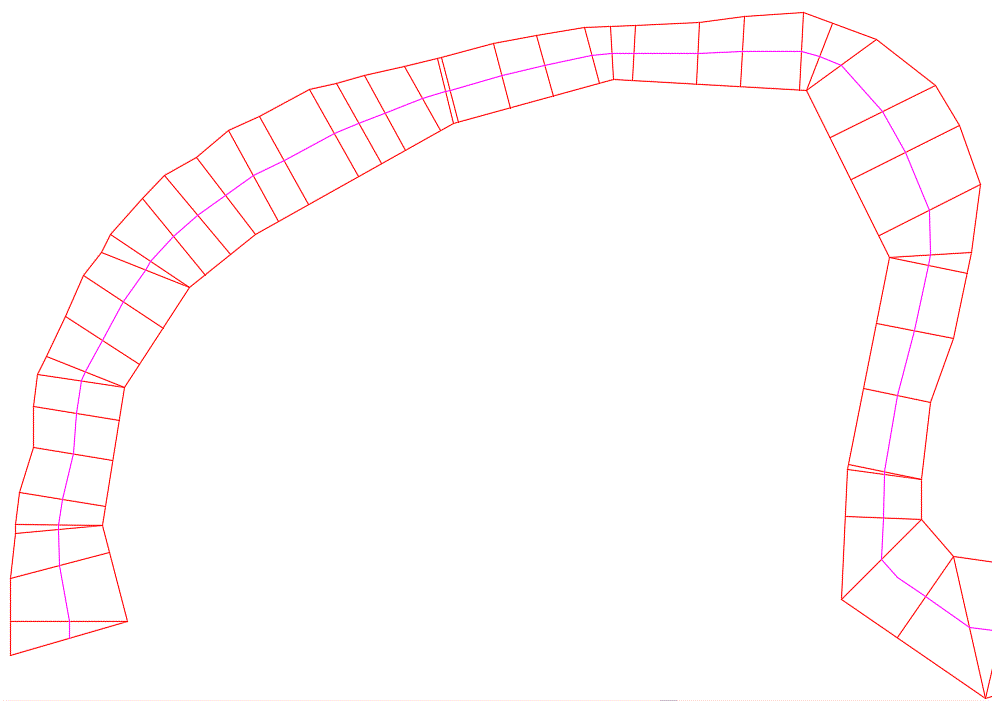

Basically I try to draw a polyline equidistant to the reference lines. To do this, I draw perpendiculars from each point of each polyline to the closest segment of the other. Sometimes several points are concentrated in one of the polylines while in the other polyline there is only one long segment. In these cases, I draw all the perpendiculars that intersect that long segment, but for the last point, I already draw a line to the end of the long segment. When the perpendicular from a point goes to the next segment to which the previous ones were in the opposite polyline, then the perpendiculars must continue being made from the opposite polyline. I suppose it is a bit complicated to explain and understand, so I attach images of what I mean. My method isn't perfect, but it's pretty close. I thought there would be a better method, one that would be more geometrically rigorous than mine. As for Lee Mac's code, I must thank him for sharing his knowledge and his great code I've tested it, and the result is pretty close to what the true axis between the two polylines should be. But it still deviates in the pivot areas. Also, the result varies depending on the order in which the polylines are selected, and this isn't good. A robust method should produce the same result in both cases. My idea was that it should be possible to obtain an axis in which any perpendicular to it is equidistant from the reference polylines. But I'm starting to think this isn't so easy.
I guess you could do like (setq i (+ i 0.01)) 16 vertex poly would then create a 1600 vertex poly And then run overkill on the created polyline to remove all collinear vertexes.

I guess the solution is to programme how you currently do this - what is your manual method? As for a solution, haven't looked how SLW210 does his but might expand MHUPP to use both polylines and find the mid points using all verticies.
You can try this...I am not sure how accurate it will be for you, but 100-500 sample size looked pretty good on your drawing, you can change the default, but I kept it at 50 for myself. ;;; Draw a polyline centered between two selected polylines (can be dissimilar/irregular). ;;; ;;; https://www.cadtutor.net/forum/topic/98778-hybrid-parallel/#findComment-676800 ;;; ;;; By SLW210 (a.k.a. Steve Wilson) ;;; (defun c:DrawCl (/ pl1 pl2 num-pts len1 n dist step pt1 pt2 midpt pts) (vl-load-com) ;; Select first polyline (setq pl1 (car (entsel "\nSelect first polyline: "))) (if (not (and pl1 (= (cdr (assoc 0 (entget pl1))) "LWPOLYLINE"))) (progn (princ "\nInvalid first selection.") (exit)) ) ;; Select second polyline (setq pl2 (car (entsel "\nSelect second polyline: "))) (if (not (and pl2 (= (cdr (assoc 0 (entget pl2))) "LWPOLYLINE"))) (progn (princ "\nInvalid second selection.") (exit)) ) ;; Set number of sample points to use (it uses last number entered, default is 50) (if (not *CL_lastNumPts*) (setq *CL_lastNumPts* 50)) (setq num-pts (getint (strcat "\nEnter number of sample points <" (itoa *CL_lastNumPts*) ">: ") ) ) (if (null num-pts) (setq num-pts *CL_lastNumPts*)) (setq *CL_lastNumPts* num-pts) ;; Calculate (setq len1 (vlax-curve-getDistAtParam pl1 (vlax-curve-getEndParam pl1))) (setq step (/ len1 num-pts)) (setq dist 0.0 pts '() ) ;; Midpoint list (repeat (1+ num-pts) (setq pt1 (vlax-curve-getPointAtDist pl1 dist)) (setq pt2 (vlax-curve-getClosestPointTo pl2 pt1)) (if (and pt1 pt2) (setq pts (cons (mapcar '(lambda (a b) (/ (+ a b) 2.0)) pt1 pt2) pts)) ) (setq dist (+ dist step)) ) ;; Create polyline (if pts (progn (setq pts (reverse pts)) (entmake (append (list (cons 0 "LWPOLYLINE") (cons 100 "AcDbEntity") (cons 100 "AcDbPolyline") (cons 90 (length pts)) (cons 70 0) ) (mapcar '(lambda (p) (cons 10 p)) pts) ) ) (princ "\nCenterline drawn accurately between polylines.") ) (princ "\nNo points generated — check polylines.") ) (princ) ) (princ "\nType DrawCl to draw a centerline between two polylines.") (princ) That said, I just tried Lee Mac's cPoly in mhupp's last link posted, seems to be similar results to mine if you adjust the sample points. I haven't checked the others yet, I'll run through them if I get time. I originally made mine with the command function, then changed it to entmake, pretty sure the accuracy is the same, it just had a lot of "Specify next point or [Arc/Close/Halfwidth/Length/Undo/Width]:" in the commandline for each sample. P.S. Mine should take into account reversed polylines. At the same sample size, mine and Lee Mac's seem to be exactly the same on your drawing. I still have to do on mine, set a layer and linetype option in the code.

See what this does. https://www.cadtutor.net/forum/topic/14213-lisp-to-create-polyline-between-polylines/#findComment-117973
