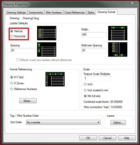

What version of AutoCAD Electrical? Unless it's changed, you go to Drawing Properties under the Drawing Format tab and select "Vertical" under Ladder Defaults.

bustr started following Ladder orientation
Autodesk seems to go out of their way to match the difficulty of intools, lotus notes and IFP-PRO. Can anyone tell me why my ladder is horizontal (There was no option in the dialog box for orientation.), why it has more rungs than specified, why there are no busses and why there is an "X" at the end. Autodesk's forums are useless so I don't expect to get an answer from them.
