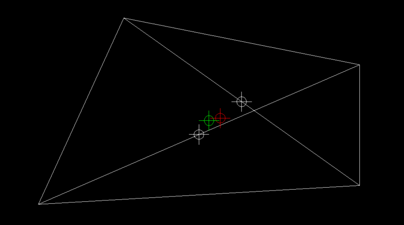

Geometric center of open polyline, line
BIGAL replied to maahee's topic in AutoLISP, Visual LISP & DCL
Not quite the middle of say 2 points. The red is the average answer. The green is gcen. so 4 answers. If the shape is say 4 points then you could force a close get the Gcen then do a undo. -
