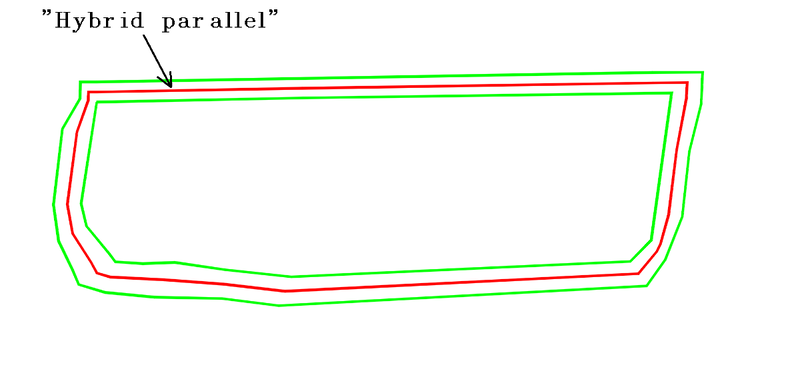

Maybe select both polylines find the polyline that has the most vertex Then process those vertex with vlax-curve-getClosestPointTo store the mid point of vertex and closest point in a list entmake new polyline with list points.

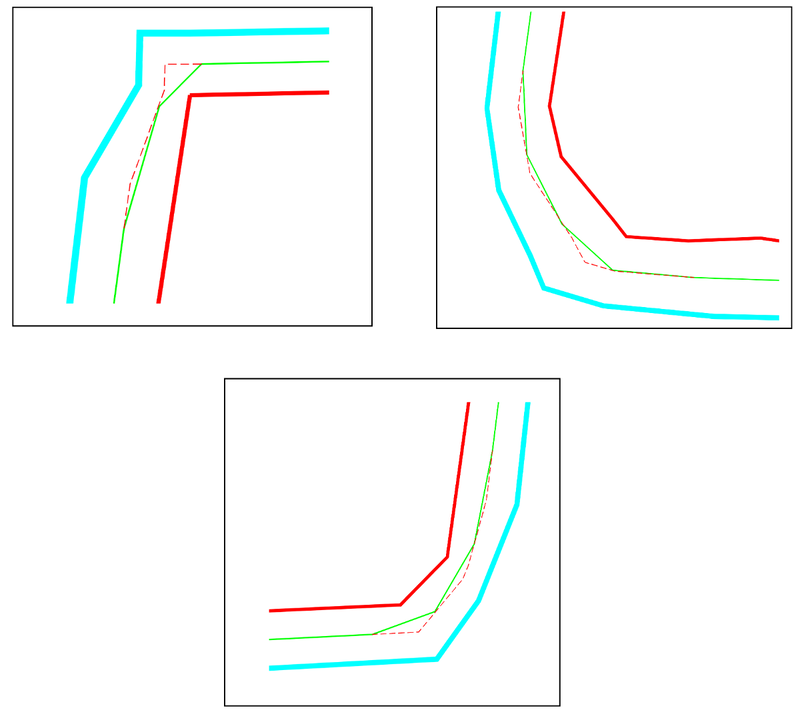

@pkenewell Thank you very much. I finally got it working. In my case, I set the "length of arcs" to 1. And it worked. But I think the resulting axis isn't very geometrically rigorous. I've attached an example image: -The polyline created by the command is shown in green. -The correct geometry of the axis is shown in dashed red. I think there should be a more geometrically rigorous solution in some older Lisp. Is it possible? Does anyone know of one?

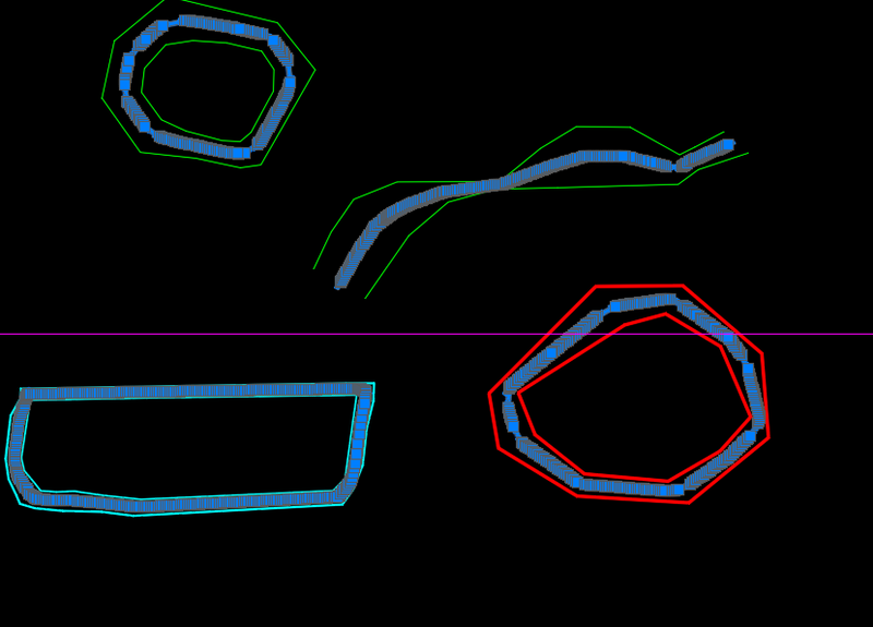

The "MC" command by roy437 works for me on your example drawing. You have to set the point resolution (prompt for "Specify Length for arc(ds)") to improve the results. I used 0.1 for pretty good results.
The code does not work correctly with polylines that have a large number of segments. Example1.dwg
I attach an example Example.dwg
@pkenewell Thanks for help. I downloaded the latest code from link and loaded it, but it doesn't seem to do anything. I probably don't understand how it works.
@NikonThanks for the code. I tried it. But it only works sometimes. And if the polylines' first point coincides with the last, it doesn't work. Is it possible that I'm doing something wrong?

Perhaps the most appropriate description is to obtain the axis between 2 irregular polylines

Hi again. This may also happen to others: sometimes I have two polylines and I need to get something like a common parallel to both. A sort of hybrid parallel from the original two. Is it possible that this topic has been discussed in the history of this forum and there is a LISP to solve this problem? Thanks in advance.
