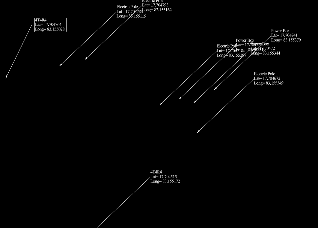

    @pmadhwal7 Looks like you had this same problem in 2019. MLEADERS were suggested to you then and you didn't try the tools offered? I did the following with a LEADER to MLEADER conversion very quickly:

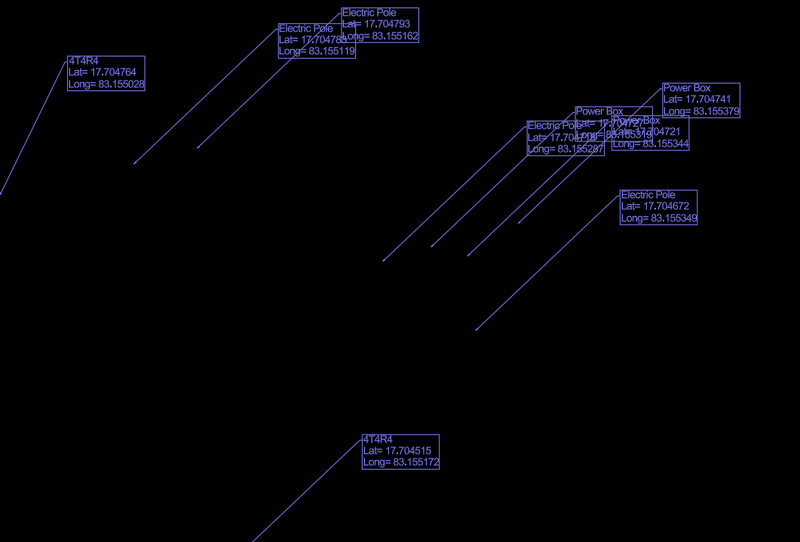

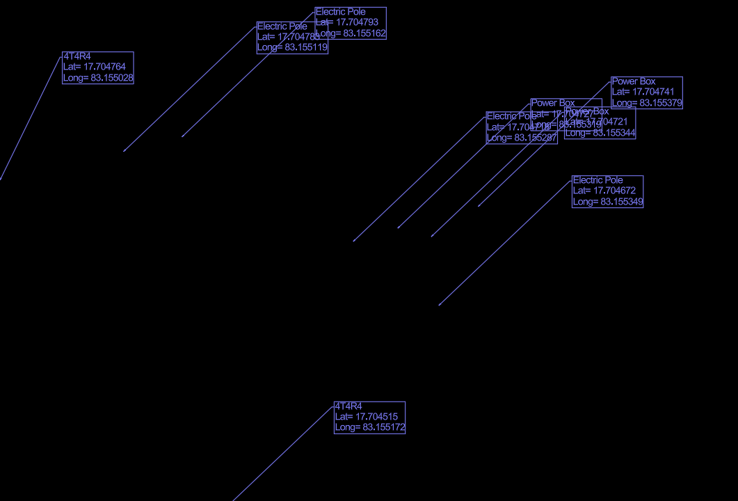

    leader and mtext are not attaching
    @pkenewellthis is the actual file i was attached after that we rotate it and make it like seen in screenshot, leader and text are zero digree roation the curret leader text are easy to move and rotate so we use those if u have any other method kindly shre
  7. pkenewell
    Yes - I checked you file, but the first time, I just used my convert to MLEADER program and successfully did ALL the annotations. Going back into it now, I see the the QLATTACH and QLATTACHSET is not working for every leader. I can't explain why sorry. There is no error message on some - it just does not do it.
  8. pmadhwal7
    @pkenewellsir did u check my file?
  9. pkenewell
    @pmadhwal7 You cannot attach the text to standard LEADER objects so they move together. They would at least have to be converted to QLEADERS. MLEADERS are better. I convert all my old leaders to MLEADERS using a similar program, so that the text stays with the leader. PS: The express tools "Annotation Attachment > Attach Leader to Annotation" works with the older leaders like @mhupp said, using reactors (Makes it a QLEADER effectively). However, to move the leader, you always have to move the TEXT first. If you move the leader end point near the text first, the text will stay where it is. That's why MLEADERS are better!
  10. pmadhwal7
    no through global attached leader commond those types of leader text not join i tried that too

    THIS CODE CONVERTING LEADER TO MLEADER AND I DIN'T REQUIRED MLEADER

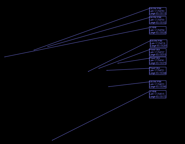

  21. i was facing issue when i was associating leader with m-text some of are associting but too many are not i was try it too many time but not got the result, my screeshot and dwg are attached pls if anyone help me this is very crucial and important task for me leader.dwg
