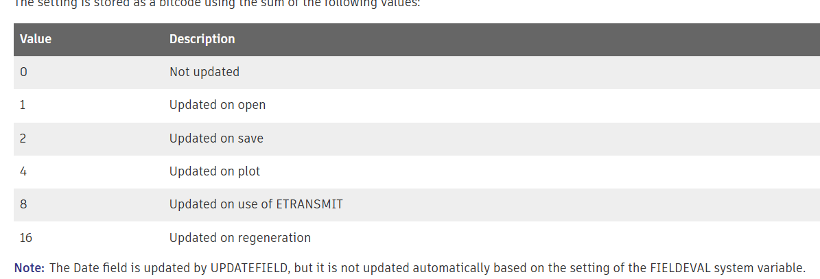

  2. Went away and had a look at why 31. Sum the values.
  3. Yesterday
  4. @zaphod That's a good one, thank you!
  5. the system/drawing variable "fieldeval" is set to 4, it needs to be set to 31 in order to visibly see it update. Drawing2.dwg
