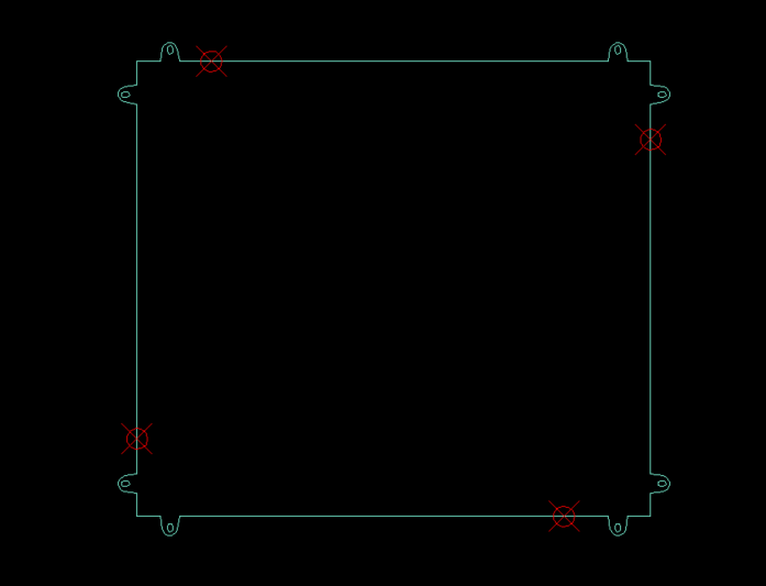

Please have a look at this, it makes a rectang then you can add the "TAB" to any side, even on an angle. The red points are the pick points working in a clock wise direction, if you pick wrong end the TAB will go inwards. I made a Block called " TAB" and used your dwg to set the edge distances. I did adjust the block ever so slightly it had like 33.70123 so set it to 33.7. here is also your dwg with the TAB block added. If your happy will add the Squares, again based on the rectang size. (defun c:wow ( / oldsnap pt1 pt2 pt3 pt4 ang tabwid) (setq oldsnap (getvar 'osmode)) (setq oldang (getvar 'aunits)) (setq ht 800.0 tabedge 41.0 tabwid 33.7) (setq pt1 (getpoint "\nPick 1st point ")) (setq len (getdist pt1 "\nPick 2nd point ")) (setq pt2 (mapcar '+ pt1 (list len 0.0 0.0)) pt3 (mapcar '+ pt1 (list len ht 0.0)) pt4 (mapcar '+ pt1 (list 0.0 ht 0.0)) ) (setvar 'osmode 0) (setvar 'aunits 3) (command "Line" pt1 pt2 pt3 pt4 "c") (while (setq ent (entsel "\nPick near start end - Enter to stop ")) (setq ept (cadr ent)) (setq ent (car ent)) (setq entg (entget ent)) (setq start (cdr (assoc 10 entg))) (setq end (cdr (assoc 11 entg))) (setq len2 (distance start end)) (setq d1 (distance ept start)) (setq d2 (distance ept end)) (if (> d1 d2) (progn (setq temp start) (setq start end) (setq end temp) ) ) (setq ang (angle start end)) (setq pt5 (polar start ang tabedge)) (setq pt6 (polar pt5 ang tabwid)) (command "break" ent pt5 pt6) (command "insert" "TAB" pt5 1 1 ang) (command "explode" (entlast)) (setq pt5 (polar start ang (- len2 tabwid tabedge ))) (setq pt6 (polar pt5 ang tabwid)) (command "break" ent pt5 pt6) (command "insert" "TAB" pt5 1 1 ang) (command "explode" (entlast)) ) (setq pt3 (mapcar '+ pt3 (list 40 40 0.0))) (setq pt1 (mapcar '+ pt1 (list -40 -40 0.0))) (command "join" "w" pt3 pt1 "") (setvar 'osmode oldsnap) (setvar 'aunits oldang) (princ) ) (c:wow) The array does have a pattern so your multi if's could become as simple, as (fix (- (/ length 75) 1)) just try it. Vertical rows is 9 for 800. (setq col (fix (- (/ 1220.234 75) 1))) (setq bname (strcat "*Infil_sq_" (rtos col 2 0))) Is the length overall or the distance between the centre points of the slots. Can fix length to match. Need you to confirm what this length is based on. Infil Panels AutoLisp Test-TAB.dwg

I still think much easier to just select a line or pline near an end, then draw the tab based on some sort of sizes criteria, after doing the code i realised only really need one draw tab portion so can be on any segment and a bonus at any angle of the selected P/Line. The tab would be drawn and a simple flip to set it to inside or outside. You can pick say 4 times very fast. Even shapes would work. Why not just have the tab as a block, much easier to work with. Will have a think about it. Oh yeah I think the infill can be done as an array rather than having lots of blocks. Found your post over at forums/autodesk as well.
