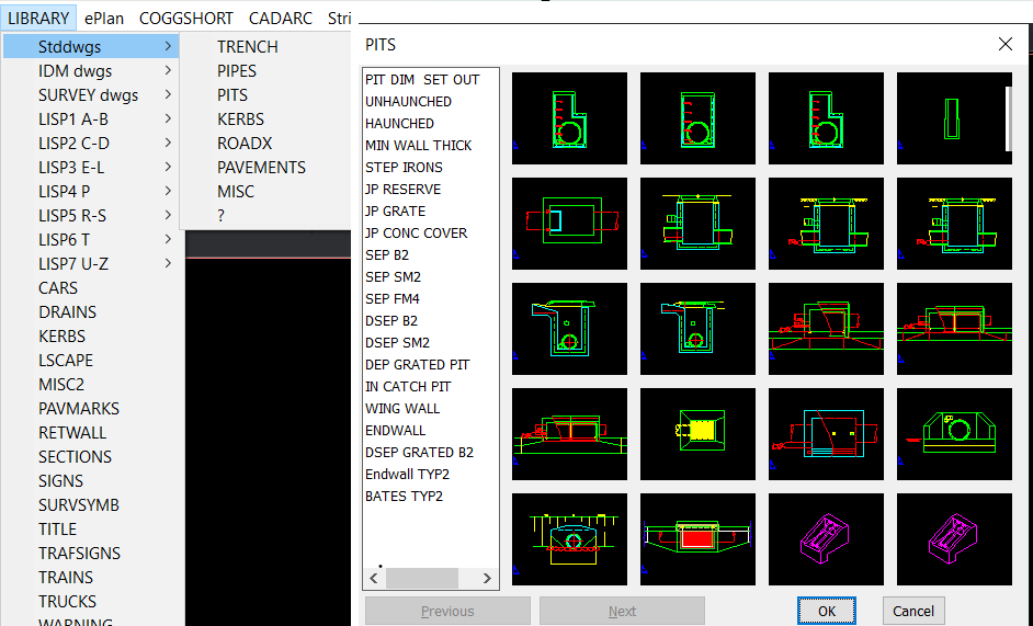

  2. Been using this for like 40 years, if you can use Notepad then you can make a pop menu and select correct block. Note the blocks are saved in separate directories by category. Further down the master Library is more Block by category..
