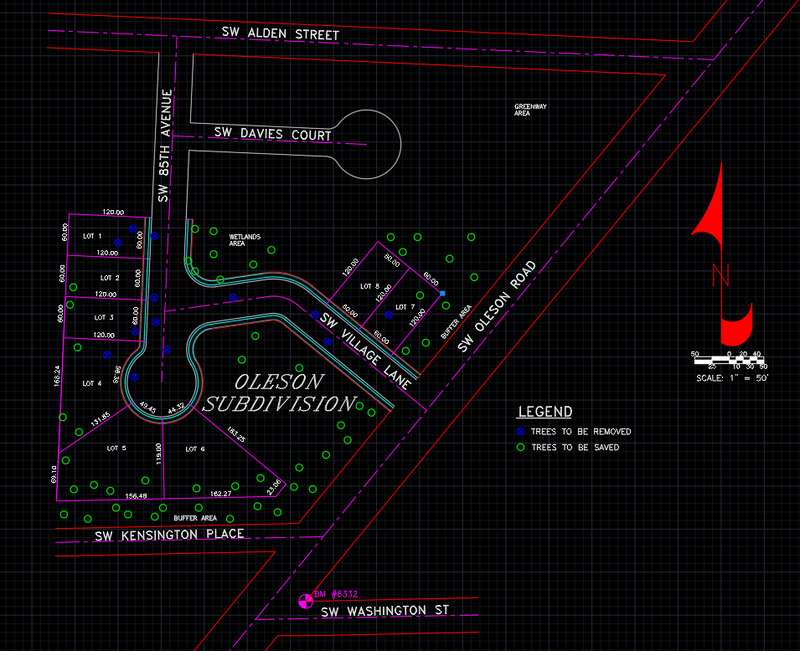

Penn Foster Student Suffering with Oleson Village Map!!!

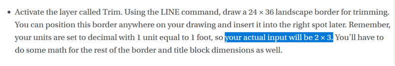

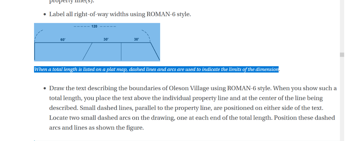

Val replied to AutoCad Student's topic in Student Project Questions
Hello, I'm at the final steps for this project and I'm stuck on 2 parts. First is the dimensioning the total length of the lot sides added together. It says to use a dashed line for the arc and line, but the list of layers never mentions a layer that uses dashed lines. Is this some sort of annotation setup that I'm overlooking? And is there a command for the having the ends of the dimension being arcs, or do I need to make those manually? Second part is the setup for the border. I understand it's a 24 x 36 and that 1 unit equals 1 foot and that I will need to scale it up once created. But then they throw in the line that the actual input is 2 x 3 and I'll have to figure out the math. This is throwing me for a loop, or possibly my brain has just turned to mush from overthinking it. Thanks in Advance for the help. -
