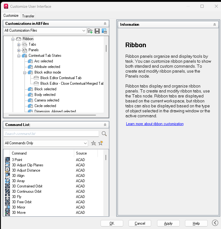

  2. Is this what your asking about? AFAIK this is only a Contextual menu, it would be there when opening the Block Editor custom workspace or not. All of my workspaces show an entry for the Ribbon menus, but it only shows those regularly available, not any of the Contextual menus, though LT may be limited in the CUI, I'm not sure.

  4. I can't figure out how to add commands to the block editor ribbon in my CUI file, specifically, the Parameters Manager. When I open my CUI and select my workspace there doesn't seem to be a ribbon section for the block editor, or at least I cannot find it. Can someone guide me to where it is please? Is it something to do with it being hidden until the block editor is active?
