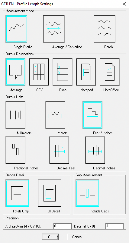

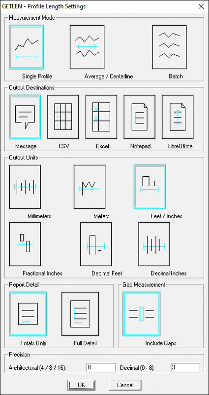

"3) Horizontal slide bar to list box" not sure if you mean like this a horizontal slider. as you move it the item in in the list box is selected. A slider uses a min max number and step size. So could do "1 to length of list", step of 1. This has 3 sliders and updates total. Sliders arrows are not clear in image. "6) A select file dialog box " thumbnails choice. Your "pl_getfiledps.lsp" when the explorer is opened click on the "More" option and can see icons etc.
