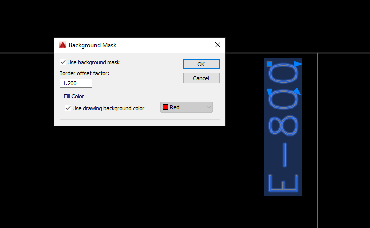

Hi GLAVCVS, can you help me? When creating a grid with Lisp, is it possible to change the text style? Specifically, change it from plain text to multiple text and add a 1.2 background mask. -

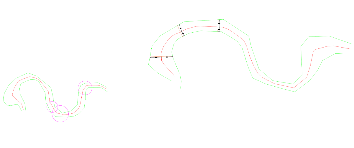

https://www.cadtutor.net/forum/topic/98778-hybrid-parallel/page/2/#findComment-676816 The last code i posted works well on two open polylines. its just when they loop back on themselves that only checking the distance gets points get out of order. haven't had time to code but I think I have a solution creating a dotted pair list.
- Today
In the DWG files you posted, I can't find the polylines indicated in the images. I don't think that result was obtained with CPL. I'd like to run a test, so please attach the DWG file with the reference position in the images. Thanks

Here is my first attempt at this problem. It creates offset lines and checks the intersections. The precision is dictated by the offsetdistance. The lower it is, the longer it takes to make the polyline and the more points it will have. But it will be more accurate. Afterwards I run this function on the resulting polyline to clean it up. ;| ; Center line - dexus ; https://www.cadtutor.net/forum/topic/98778-hybrid-parallel |; (defun c:testcl (/ ent1 lst offset offsetdistance pts r s1 s2 ss start te1 te2) (defun _polyline (pts) (entmakex (append (list (cons 0 "LWPOLYLINE") (cons 100 "AcDbEntity") (cons 100 "AcDbPolyline") (cons 90 (length pts)) (cons 8 (getvar 'clayer)) (cons 70 0) ) (mapcar (function (lambda (x) (cons 10 x))) pts) ) ) ) (defun _side (pline pnt / cpt end target der) ; https://www.theswamp.org/index.php?topic=55685.msg610429#msg610429 (setq cpt (vlax-curve-getClosestPointTo pline pnt) end (vlax-curve-getEndParam pline) target (vlax-curve-getParamAtPoint pline cpt) der (if (and (equal target (fix target) 1e-8) (or (vlax-curve-isClosed pline) (and (not (equal (vlax-curve-getStartParam pline) target 1e-8)) (not (equal end target 1e-8))) ) ) (mapcar '- (polar cpt (angle '(0 0) (vlax-curve-getFirstDeriv pline (rem (+ target 1e-3) end))) 1.0) (polar cpt (angle (vlax-curve-getFirstDeriv pline (rem (+ (- target 1e-3) end) end)) '(0 0)) 1.0) ) (vlax-curve-getFirstDeriv pline target) ) ) (minusp (sin (- (angle cpt pnt) (angle '(0.0 0.0) der)))) ) ;; Intersections - Lee Mac ;; mod - [int] acextendoption enum of intersectwith method (defun LM:intersections ( ob1 ob2 mod / lst rtn ) (if (and (vlax-method-applicable-p ob1 'intersectwith) (vlax-method-applicable-p ob2 'intersectwith) (setq lst (vlax-invoke ob1 'intersectwith ob2 mod)) ) (repeat (/ (length lst) 3) (setq rtn (cons (list (car lst) (cadr lst) (caddr lst)) rtn) lst (cdddr lst)) ) ) (reverse rtn) ) (defun getLength (ent) (vlax-curve-getDistAtParam ent (vlax-curve-getEndParam ent)) ) (if (not (while (cond ((not (setq ss (ssget '((0 . "LWPOLYLINE"))))) (princ "\nNothing selected. Try again...\n") ) ((/= (sslength ss) 2) (princ "\nSelect 2 polylines! Try again...\n") ) ((and (setq ent1 (ssname ss 0)) (setq ent2 (ssname ss 1)) (setq ent1 (vlax-ename->vla-object ent1)) (setq ent2 (vlax-ename->vla-object ent2)) ) nil ; Stop loop ) ) ) ) (progn (setq s1 (_side ent1 (vlax-curve-getStartPoint ent2))) (setq s2 (_side ent2 (vlax-curve-getStartPoint ent1))) (setq maxlen (max (getLength ent1) (getLength ent2))) (setq offset 0.0) (setq offsetdistance (/ maxlen 1024.0)) (while (progn (setq offset (+ offset offsetdistance)) (setq te1 nil) (setq te2 nil) (setq r (cond ( (or ; Make offset (vl-catch-all-error-p (setq te1 (vl-catch-all-apply 'vlax-invoke (list ent1 'Offset (if s1 offset (- offset)))))) (vl-catch-all-error-p (setq te2 (vl-catch-all-apply 'vlax-invoke (list ent2 'Offset (if s2 offset (- offset)))))) ) (princ "\nOffset failed. ") nil ) ((setq lst (LM:intersections (car te1) (car te2) acExtendNone)) (setq len (getLength (car te1))) (setq lst (mapcar (function (lambda (pt) (list (/ (vlax-curve-getDistAtPoint (car te1) pt) len) pt))) lst)) (setq start t) (setq pts (append lst pts)) ) ((> offset maxlen) nil) ((not start) t) (start nil) ) ) (if te1 (mapcar 'vla-delete te1)) (if te2 (mapcar 'vla-delete te2)) r ) ) (if pts (_polyline (mapcar 'cadr (vl-sort pts (function (lambda (a b) (< (car a) (car b))))))) ) ) ) )

I already stated that in a few posts. All of them fail in certain situations. That's why people are still taking a shot at solving the issue. I have also already mentioned Civil/GIS programs can do this pretty well. QGIS (free/donation) has a plug-in to do this.

Dear friend GLAVCVS, thank you so much for your reply. The routine worked perfectly. I'm very grateful for your help. Regards -
help to improve lisp routine, (coordinate grid)
GLAVCVS replied to Omar ugarte's topic in AutoLISP, Visual LISP & DCL
Hi Omar. Bienvenido Try this (defun strpto (aa / largo) (setq largo (strlen aa)) (cond ((< largo 4) aa) ((= largo 6) (strcat (substr aa 1 3) "." (substr aa 4 3))) ((= largo 7) (strcat (substr aa 1 1) "." (substr aa 2 3) "." (substr aa 5 3) ) ) (t aa) ) ) ;;;;;;;;;;;;;;;;;;;;;;;;;;;;;;;;;;;;;;;;;;;;;;;;;;;;;;;;;;;;;;;;;;;;;;;;;; ;; DatosLineas : obtiene los coeficientes necesarios para determinar las ;; rectas que definen el area a cuadricular. Las cuales son ;; de la forma : a*x + b*y = c ;; (Defun DatosLineas (p1 p2 p3 p4) (setq a1 (- (cadr p2) (cadr p1)) a2 (- (cadr p4) (cadr p2)) a3 (- (cadr p3) (cadr p4)) a4 (- (cadr p1) (cadr p3)) b1 (- (car p1) (car p2)) b2 (- (car p2) (car p4)) b3 (- (car p4) (car p3)) b4 (- (car p3) (car p1)) c1 (- (* (car p1) (cadr p2)) (* (car p2) (cadr p1))) c2 (- (* (car p2) (cadr p4)) (* (car p4) (cadr p2))) c3 (- (* (car p4) (cadr p3)) (* (car p3) (cadr p4))) c4 (- (* (car p3) (cadr p1)) (* (car p1) (cadr p3))) ) ) ;;;;;;;;;;;;;;;;;;;;;;;;;;;;;;;;;;;;;;;;;;;;;;;;;;;;;;;;;;;;;;;;;;;;;;;;;; ;; ;; Punto de la recta dada por a,b,c dada la cordenada Y ;; (Defun CalculaX (a b c y) (if (= 0.0 a) ; no hay interseccion nil (/ (- c (* b y)) a) ) ) (Defun IntersecX (/ l lista) (setq l () lista (list (CalculaX a1 b1 c1 startY) (CalculaX a2 b2 c2 startY) (CalculaX a3 b3 c3 startY) (CalculaX a4 b4 c4 startY) ) ) (while (/= lista nil) (setq x (car lista)) (if (and (/= x nil) (<= x maxX) (>= x minX)) (setq l (append l (list x))) ) (setq lista (cdr lista)) ) (list (min (car l) (cadr l)) (max (car l) (cadr l))) ) ;;;;;;;;;;;;;;;;;;;;;;;;;;;;;;;;;;;;;;;;;;;;;;;;;;;;;;;;;;;;;;;;;;;;;;;;;; ;; ;; Interseccion dada la cordenada X ;; (Defun CalculaY (a b c x) (if (= 0.0 b) ; no hay interseccion nil (/ (- c (* a x)) b) ) ) (Defun IntersecY (/ l lista) (setq l () lista (list (CalculaY a1 b1 c1 startX) (CalculaY a2 b2 c2 startX) (CalculaY a3 b3 c3 startX) (CalculaY a4 b4 c4 startX) ) ) (while (/= lista nil) (setq y (car lista)) (if (and (/= y nil) (<= y maxY) (>= y minY)) (setq l (append l (list y))) ) (setq lista (cdr lista)) ) (list (min (car l) (cadr l)) (max (car l) (cadr l))) ) (defun dameEsquinas (e / le lp) (if (= (cdr (assoc 0 (setq le (entget e)))) "LWPOLYLINE") (foreach l le (if (= (car l) 10) (setq lp (cons (cdr l) lp)) ) ) ) (if lp (vl-sort lp '(lambda(a b) (< (car a) (car b))))) ) ;;;;;;;;;;;;;;;;;;;;;;;;;;;;;;;;;;;;;;;;;;;;;;;;;;;;;;;;;;;;;;;;;;;;;;;;;; ;; ;; Programa principal ;; (Defun c:grilla (/ p1 p2 p3 p4 paux incx incy l h n maldato base alfa startX startY minX minY maxX maxY ) (setvar "CMDECHO" 0) (command "_.undo" "_begin") (command "osnap" "off") (command "units" "2" "3" "3" "4" "e" "n") (command "LAYER" "M" "TO-GRILLA" "C" "8" "" "") (command "style" "romand" "romand" 0 1 0 "N" "N" "N") (setq incrx 0) ;;; (setq p1 (getpoint "\nIngrese un vertice de la region ") ;;; p2 (getpoint p1 "\nIngrese el otro vertice ") ;;; ) ;;; (command "LINE" p1 p2 "") (if (not (setq e (car (entsel "\nSelecciona el marco para la grilla...")))) (exit) ) (setq l (dameEsquinas e) p1 (car l) p2 (cadr l) p3 (caddr l) l nil ) (if (> (cadr p1) (cadr p2)) ; siempre el p1 abajo (setq paux p1 p1 p2 p2 paux ) ) (setq p3 (getpoint p1 "\nIngrese punto para Ancho de la region ") l (distance p1 p3) ; calculo de puntos p3 y p4 , paralelos alfa (angle p1 p2) ; a p1 y p2 a distancia l alfa (+ (/ pi 2) alfa) ) (if (> (car p3) (car p1)) (setq alfa (+ pi alfa)) ) (if (= (car p1) (car p3)) (if (< (* (- (car p2) (car p1)) (- (cadr p3) (cadr p1))) 0.0) (setq alfa (+ pi alfa)) ) ) (setq p3 (list (+ (car p1) (* l (cos alfa))) (+ (cadr p1) (* l (sin alfa))) ) p4 (list (+ (car p2) (* l (cos alfa))) (+ (cadr p2) (* l (sin alfa))) ) ) (command "LINE" p1 p2 p4 p3 "C") ; marco exterior (if (< (cadr p3) (cadr p1)) ; punto1 siempre mas bajo (setq paux p1 p1 p3 p3 paux paux p2 p2 p4 p4 paux ) ) (setq minX (min (car p2) (car p3)) maxX (max (car p2) (car p3)) minY (cadr p1) maxY (cadr p4) l (- maxX minX) h (- maxY minY) malDato 1 ) (while (= malDato 1) (setq incx (getreal "\nIncremento malla (m) :")) (if (< (abs (/ l 3)) incrx) (print "\nIncremento muy grande") (setq malDato 0) ) ) (setq incy incx) (setq n (fix (/ minX incx)) ; posiciones donde comenzar startX (* (1+ n) incx) ; el cuadriculado n (fix (/ minY incy)) ; tanto en X como en Y startY (* (1+ n) incy) largoMax (max (distance p1 p3) ; el largo maximo de la region (distance p1 p4) ) ) (if (< minX 0) (setq startX (- startX incx)) ) (if (< minY 0) (setq startY (- startY incy)) ) (setq ff (getreal "\nIngrese Alto (mm) :")) (setq escala (getreal "\nEscala : ")) (setq alto (* (/ ff 1000) escala)) ; alto de los caracteres (setq angP1P3 (angle p1 p3) angP1P2 (angle p1 p2) angBorde (min (abs angP1P3) (abs angP1P2)) dh (min (/ incx 40.0) (/ incy 40.0)) x1 minX ; el caso en que no hay que rotar x2 maxX y1 minY y2 maxY ) (if (or (= (cadr p1) (cadr p2)) (= (car p1) (car p3)) (= (car p1) (car p2)) ) (setq revisar 0 dl (min (/ incx 30.0) (/ incy 30.0)) ) (setq revisar 1 dl (* (* alto (/ (cos angBorde) (sin angBorde))) 2) ) ) (DatosLineas p1 p2 p3 p4) (while (< startY maxY) (if (= revisar 1) (setq ptos (IntersecX) x1 (car ptos) x2 (cadr ptos) ) ) (setq coordY (rtos startY 2 0) coordY (strcat "N-" (strpto coordY)) ) (command "LINE" (list x1 startY) (list x2 startY) "") (cond ((> (- maxY startY) (* 2 alto)) (command "TEXT" (list (+ x1 dl) (+ startY dh)) alto 0 coordY ) (command "TEXT" "R" (list (- x2 dl) (+ startY dh)) alto 0 coordY ) ) ) (setq startY (+ startY incy)) ) (while (< startX maxX) (if (= revisar 1) (setq ptos (IntersecY) y1 (car ptos) y2 (cadr ptos) ) ) (setq coordX (rtos startX 2 0) coordX (strcat "E-" (strpto coordX)) ) (command "LINE" (list startX y1) (list startX y2) "") (cond ((> (- startX minX) (* 2 alto)) (command "TEXT" (list (- startX dh) (+ y1 dl)) alto 100 coordX ) (command "TEXT" "R" (list (- startX dh) (- y2 dl)) alto 100 coordX ) ) ) (setq startX (+ startX incx)) ) (if (> (distance p1 p3) (distance p1 p2)) (setq alfa angP1P3) (setq alfa angP1P2) ) (if (or (/= alfa pi) (/= alfa 0.0)) (setq alfarad (* -1 alfa) alfa (* -1 (/ (* 200 alfa) pi)) p4 (list (- (* (car p4) (cos alfarad)) (* (cadr p4) (sin alfarad))) (+ (* (car p4) (sin alfarad)) (* (cadr p4) (cos alfarad))) ) p1 (list (- (* (car p1) (cos alfarad)) (* (cadr p1) (sin alfarad))) (+ (* (car p1) (sin alfarad)) (* (cadr p1) (cos alfarad))) ) base (list 0.0 0.0) ; el origen ) ) (command "_.undo" "end") (command "_.undo" "auto" "on") ;; (command "units" "2" "3" "3" "4" "n" "y") ) The "command" calls in your code are designed for an English version of AutoCAD, and mine is in Spanish. For this reason, and due to lack of time, I haven't tested the code sufficiently. Try it yourself and then comment on the results. -
