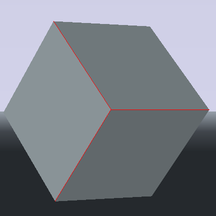

  2. With ARX, you can use Brep or AssocPersSubentIdPE, the later is a bit simpler to use. AssocPersSubentIdPE will get you the faces, edges, and vertices of the solid. In the case of a cuboid, simply get all the edges and map them to a vertex In this example each vertex should be mapped to three edges. You could then build a transformation matrix so you can accurately compute the dimensions. It starts to get a lot harder with more complex shapes. There’s a few threads at the swamp discussing ideas how to work with I-beams, how to find the edge the run along the length for reference import traceback from pyrx import Ap, Ax, Ge, Ed, Db, command from collections import defaultdict @command def doit(): ps, id, pnt = Ed.Editor.entSel("\nPick it: \n", Db.Solid3d.desc()) solid = Db.Solid3d(id) pe = Db.AssocPersSubentIdPE(solid.queryX(Db.AssocPersSubentIdPE.desc())) edge_map = defaultdict(list[Ge.Curve3d]) for vrt in pe.getAllSubentities(solid, Db.SubentType.kVertexSubentType): edge_map[pe.getVertexSubentityGeometry(solid, vrt)] for edge in pe.getAllSubentities(solid, Db.SubentType.kEdgeSubentType): crv = pe.getEdgeSubentityGeometry(solid, edge) edge_map[crv.getStartPoint()].append(crv) edge_map[crv.getEndPoint()].append(crv) for k, v in edge_map.items(): for _crv in v: Ed.Core.grDraw(_crv.getStartPoint(), _crv.getEndPoint(), 1, 0) return
