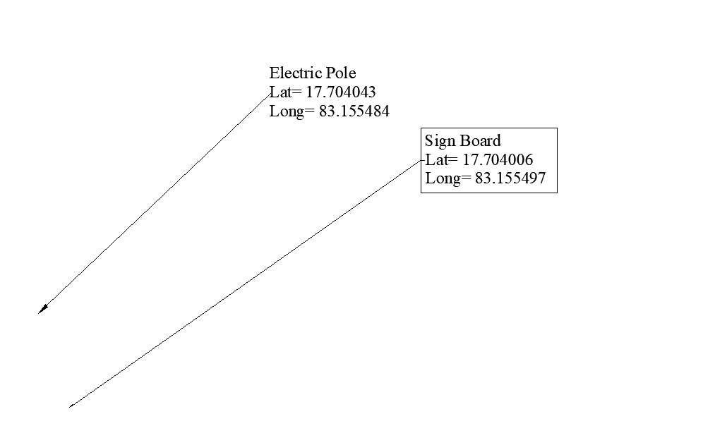

  2. i was facing issue when i was associating leader with m-text some of are associting but too many are not i was try it too many time but not got the result, my screeshot and dwg are attached pls if anyone help me this is very crucial and important task for me leader.dwg
