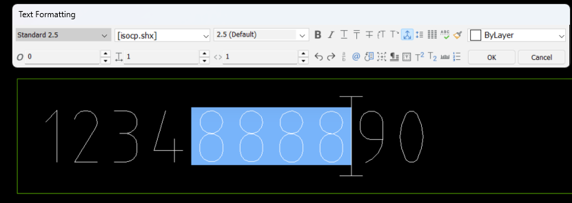

How can I make the following program support Chinese input?
BIGAL replied to xcn's topic in AutoCAD 2D Drafting, Object Properties & Interface
Still for me your just replacing the inbuilt mtext ability. The Mtext should support Chinese characters. 1 Select mtext, using dbl click 2 Highlite characters 3 Edit characters 4 Press OK - Today
SLW210 replied to xcn's topic in AutoCAD 2D Drafting, Object Properties & Interface
I was just suggesting a rewrite, though I think maybe it is just a Unicode issue so it might be altered. That's what I came back with on an internet search for change AutoCAD LISP from English input to Chinese and the articles I read stated Chinese has double-byte Unicode, the GRREAD may also be an issue. LISPSYS=2 is necessary. Is this on a Chinese Simplified version of AutoCAD, Windows , etc.? Give some more detailed information on the setups this will be used. I just started studying Chinese a few weeks ago, so I want be a ton of help on that end and haven't got into the characters yet. -
xcn replied to xcn's topic in AutoCAD 2D Drafting, Object Properties & Interface
@BIGAL The goal isn’t just to change color. This AutoLISP routine is an interactive character-level editor for a single-line TEXT entity. It lets you: 1. Select an existing TEXT object. 2. Move the mouse along the text to highlight a range of characters. 3. Type replacement characters. 4. Press Enter or Space to replace the highlighted range in the original text. The temporary red text created by ht:paint is only a visual highlight of the selected character range. It is not meant to permanently change color. -
Not sure what your trying to achieve. Could you describe more. If it's about changing color then just use mtext. - Yesterday
I came up with it. If it could be completely rewritten, that would be great. -
From where did that LISP originate? Mandarin? Glancing through that LISP a little, I am almost positive the best way would be to completely write something new. -
