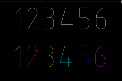

  2. Not sure what your trying to achieve. Could yo describe more. If its about changing color then just use mtext.
