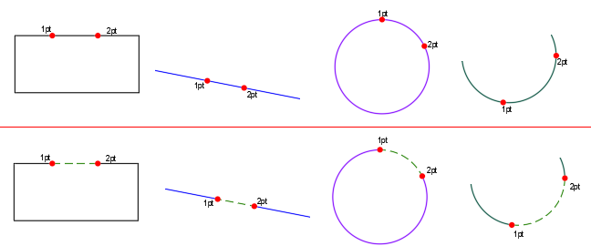

CivilTechSource replied to Nikon's topic in AutoLISP, Visual LISP & DCL
few issues with the lisp. 1) The ssget does not seem to work. 2) Creating a new line between breakpoints will not work for circles as you need to create an arc. It will also not work on curved polylines. Maybe a better way to approach it, is to select the object copy it. Trim it to pt1 & pt2 and then, break the selected objected between pt1 & pt2? -

Nikon posted a topic in AutoLISP, Visual LISP & DCL
The code should draw a dotted new line between the points, but the line is not drawn. Would it be easier to change the properties of the line between two points? Thanks... ;; AutoLISP, which allows you to select objects (line, polyline, circle, arc), ;; break them at two points and replace the selected section with a dashed line with the specified parameters (defun c:Br2ptReplDash (/ ss pt1 pt2 ent entdata newent) (setq ss (ssget '((0 . "LINE,POLYLINE,CIRCLE,ARC")))) (if ss (progn (prompt "Select the object to split: ") (setq ent (ssname ss 0)) ;; Entering the first break point (setq pt1 (getpoint " Select the first break point: ")) ;; Entering the second break point (setq pt2 (getpoint " Select the second break point: ")) ;; Checking the object type and performing the split (cond ((= (cdr (assoc 0 (entget ent))) "LINE") ;; break the line (command "_.BREAK" ent pt1 pt2) ) ((= (cdr (assoc 0 (entget ent))) "POLYLINE") ;; break polyline (command "_.BREAK" ent pt1 pt2) ) ((= (cdr (assoc 0 (entget ent))) "CIRCLE") ;; break the circle (command "_.BREAK" ent pt1 pt2) ) ((= (cdr (assoc 0 (entget ent))) "ARC") ;; break the arc (command "_.BREAK" ent pt1 pt2) ) (T (prompt "An object of an unsupported type.") ) ) ;; Get new objects after splitting (setq ss (ssget "_N" '((0 . "LINE POLYLINE CIRCLE ARC")))) ;; Sorting through objects and replacing the section with a dotted line (setq i 0) (repeat (sslength ss) (setq ent (ssname ss i)) (setq entdata (entget ent)) ;; Create a new line between the break points (setq newent (command "_.LINE" pt1 pt2 "")) ;; Setting up line properties (entmod (append newent '((8 . "0")) ; the default layer '((6 . "DASHED2")) ; line type '((70 . 0)) '((40 . 0.25)) ; thickness '((47 . 20)) ; LTSCALE '((6 . "DASHED2")))) ) ;; Color setting (entmod (append newent '((62 . 84)))) (setq i (1+ i)) ) (prompt "Processing is completed.") ) (prompt "Objects are not selected.") ) (princ) ) Br2ptReplDash.dwg -
