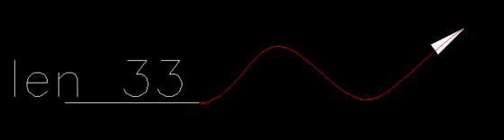

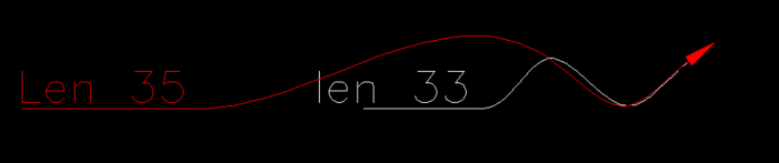

I don't think dogleglength is what you want. This example is original mleader was 33 tried dogleglength at 35 can see is way to long. Like twice the length required. it was like 70+ The only way I have found is to move either the 1st or last point and can get the desired spline length, but a big but must explode and recalc the spline point and then undo and reset the mleader then its length is correct. Or within say 1e-03 etc. I have not found a way to get a length of a mleader spline.The default dogleg length is in the Mleaderstyle, I have started to play with it set to 0.0 asked me it makes it easier to work out lengths. This shows in red what I consider the spline length. Note have to add arrow size. -
