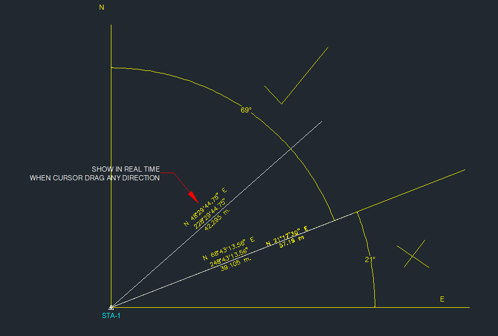

oliver replied to oliver's topic in AutoLISP, Visual LISP & DCL
Thank you the code is perfectly fine and work..but some a little adjustment here some photos and video. -
I should have used acdbAngToS which honors AUNITS

Need a routine lisp for bearing & azimuth in realtime.
Tsuky replied to oliver's topic in AutoLISP, Visual LISP & DCL

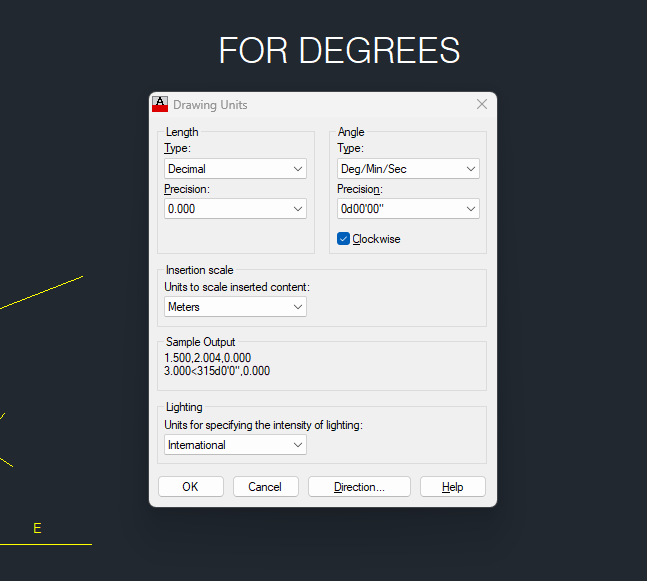

A start with this? (vl-load-com) (defun c:label_bearing ( / l_var AcDoc Space nw_style nw_obj dxf_text pt1 pt2 dxf_line key pt alpha len_l m_pt val_txt) (setq l_var (mapcar 'getvar '("DIMZIN" "ANGDIR" "ANGBASE" "AUNITS" "AUPREC" "LUPREC" "LUNITS" "TEXTSIZE"))) (mapcar 'setvar '("DIMZIN" "ANGDIR" "ANGBASE" "AUNITS" "AUPREC" "LUPREC" "LUNITS") (list 0 1 (* pi 0.5) 4 3 2 2)) (setvar "TEXTSIZE" (* (getvar "VIEWSIZE") 0.015)) (setq AcDoc (vla-get-ActiveDocument (vlax-get-acad-object)) Space (if (= 1 (getvar "CVPORT")) (vla-get-PaperSpace AcDoc) (vla-get-ModelSpace AcDoc) ) ) (vla-startundomark AcDoc) (cond ((null (tblsearch "STYLE" "BEARING")) (setq nw_style (vla-add (vla-get-textstyles AcDoc) "BEARING")) (mapcar '(lambda (pr val) (vlax-put nw_style pr val) ) (list 'FontFile 'Height 'ObliqueAngle 'Width 'TextGenerationFlag) (list "romand.shx" 0.0 0.0 1.0 0.0) ) ) ) (setq nw_obj (vla-addMtext Space (vlax-3d-point '(0.0 0.0 0.0)) 0.0 "" ) dxf_text (entget (entlast)) ) (initget 1) (setq pt1 (getpoint "\nPick base point: ") pt2 pt1 ) (entmake (list (cons 0 "LINE") (cons 10 pt1) (cons 11 pt2))) (setq dxf_line (entget (entlast))) (while (equal pt2 pt1) (setq pt2 ((lambda ( / key pt alpha len_l m_pt) (princ "\nPick other point: ") (while (and (setq key (grread T 4 0)) (/= (car key) 3)) (cond ((eq (car key) 5) (redraw) (setq pt (cadr key) alpha (angle pt1 pt) len_l (distance pt1 pt) m_pt (mapcar '* (mapcar '+ pt1 pt) '(0.5 0.5 0.5)) val_txt (vl-string-subst "%%d" "d" (strcat (angtos alpha) "\\P " (rtos len_l) " m")) dxf_line (entmod (subst (cons 11 pt) (assoc 11 dxf_line) dxf_line ) ) ) (if (and (> alpha (* pi 0.5)) (<= alpha (* pi 1.5))) (setq alpha (+ alpha pi)) ) (mapcar '(lambda (pr val) (vlax-put nw_obj pr val) ) (list 'AttachmentPoint 'Height 'DrawingDirection 'InsertionPoint 'StyleName 'Layer 'Rotation 'TextString 'Color) (list 5 (getvar "TEXTSIZE") 5 m_pt "BEARING" (getvar "CLAYER") alpha val_txt 2) ) (entmod (subst (cons 50 alpha) (assoc 50 dxf_text) (subst (cons 10 (polar m_pt (+ alpha (* pi 0.5)) (getvar "TEXTSIZE"))) (assoc 10 dxf_text) dxf_txt) ) ) ) ) ) (cadr key) )) ) ) (vla-endundomark AcDoc) (mapcar 'setvar '("DIMZIN" "ANGDIR" "ANGBASE" "AUNITS" "AUPREC" "LUPREC" "LUNITS" "TEXTSIZE") l_var) (prin1) ) -
mhupp started following Need a routine lisp for bearing & azimuth in realtime.
mhupp replied to oliver's topic in AutoLISP, Visual LISP & DCL
going to use grread and mouse pointer. maybe edit Demo2? -

Danielm103 started following bearing & azimuth in realtime
Needs work, just an example from pyrx import Ap, Db, Ed, Ge, Gi import math print("command = yeehaw") class NavJig(Ed.DrawJig): def __init__(self, basepoint): Ed.DrawJig.__init__(self) self.ds = Ed.DragStatus.kNormal self.basepoint = basepoint self.curpoint = basepoint self.mt = Db.MText() self.mt.setDatabaseDefaults() self.mt.setAttachment(Db.MTextAttachmentPoint.kMiddleLeft) def get_vector_details(self, vector: Ge.Vector3d): v_length = vector.length() azimuth_rad = math.atan2(vector.x, vector.y) azimuth_deg = math.degrees(azimuth_rad) % 360 if 0 <= azimuth_deg <= 90: bearing = f"N {azimuth_deg:.2f} E" elif 90 < azimuth_deg <= 180: bearing = f"S {180 - azimuth_deg:.2f} E" elif 180 < azimuth_deg <= 270: bearing = f"S {azimuth_deg - 180:.2f} W" else: bearing = f"N {360 - azimuth_deg:.2f} W" return f"Length: {v_length:.4f}\\P" f"{azimuth_deg:.2f}%%d " f"{bearing}" def sampler(self): self.setUserInputControls(Ed.UserInputControls.kAccept3dCoordinates) self.ds, self.curpoint = self.acquirePoint() return self.ds def update(self): if self.ds == Ed.DragStatus.kNoChange: return False return True def worldDraw(self, wd: Gi.WorldDraw): if self.ds == Ed.DragStatus.kNoChange: return True try: geo = wd.geometry() v = self.curpoint - self.basepoint self.mt.setContents(self.get_vector_details(v)) self.mt.setLocation(self.basepoint + (v * 0.5)) self.mt.setDirection(v) geo.draw(self.mt) geo.polyline([self.basepoint, self.curpoint], Ge.Vector3d.kZAxis) return True except Exception as err: print(err) @Ap.Command() def yeehaw(): try: jig = NavJig(Ge.Point3d(0, 0, 0)) jig.setDispPrompt("\nPick point:\n") res = jig.drag() print("done", res) except Exception as err: print(err)

oliver posted a topic in AutoLISP, Visual LISP & DCL
Good day once again..and Happy new year.. tired of doing manual and change the units everytime check the direction.. here is the photo. Thanks in advanced. 12.01.2026_11.15.39_REC.mp4 -
