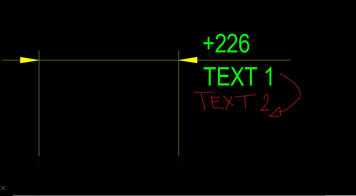

    subfix in dimension...
    @GLAVCVS IT'S OKAY, I JUST NEED IT WITHOUT HAVING TO ADD THE TEXT TO THE BEGINNING, SO TEXTS 1 AND 2 WILL ALREADY BE DEFINED WITHIN THE ROUTINE I mean I just select a dimension and the result is... true dimension accompanied by the "+" sign and below the line "text 1" and below this "text 2" (defun c:dimsub ( / enx grp idx new pos sel str ) (princ "\nColoca subfijo a dimension por debajo de linea con opcion de cambio") (if (setq sel (ssget "_:L" '((0 . "*DIMENSION")))) (repeat (setq idx (sslength sel)) (setq idx (1- idx) enx (entget (ssname sel idx)) grp (assoc 1 enx) ) (if (setq pos (vl-string-search "\\X" (cdr grp))) (setq new (cons 1 (strcat (substr (cdr grp) 1 pos) "\\X" str))) (setq new (cons 1 (strcat "+" "<>\\X" "TEXT 1))) ) (entmod (subst new grp enx)) ) ) (princ) ) this routine is from the master @Lee Mac I mean I'm looking to add a second line

    To add all the text lines you need
  7. GLAVCVS
    Another option (defun c:subTexta (/ e le txa tx cj para) (if (/= (setq tx (getstring "\nType TEXT to add?: ")) "") (while (setq n (not (setvar "NOMUTT" 1)) x (princ (strcat "\rAdd \'" tx "\' to DIMENSIONs...")) cj (ssget "_:L" '((0 . "*DIMENSION")))) (while (setq e (ssname cj (setq n (if n (1+ n) 0)))) (entmod (subst (cons 1 (cond ((or (wcmatch (setq txa (cdr (assoc 1 (setq le (entget e))))) "*<>\n*") (wcmatch txa "*<>\\X*")) (strcat txa "\n" tx)) (T (strcat txa "<>\\X" tx)))) (assoc 1 le) le ) ) ) ) ) (setvar "NOMUTT" 0) (princ) )

    I NEED TO ADD A SECOND TEXT BELOW THE FIRST
  9. leonucadomi
    master , I am trying to do the following (defun c:dimsub ( / enx grp idx new pos sel str ) (princ "\nColoca subfijo a dimension por debajo de linea con opcion de cambio") ; (if (= "" (setq str (getstring t "\nSpecify string <TYP>: "))) ;(setq str "TYP") ; ) (if (setq sel (ssget "_:L" '((0 . "*DIMENSION")))) (repeat (setq idx (sslength sel)) (setq idx (1- idx) enx (entget (ssname sel idx)) grp (assoc 1 enx) ) (if (setq pos (vl-string-search "\\X" (cdr grp))) (setq new (cons 1 (strcat (substr (cdr grp) 1 pos) "\\X" str))) (setq new (cons 1 (strcat "+" "<>\\X" "TEXT 1"))) ) (entmod (subst new grp enx)) ) ) (princ) )
