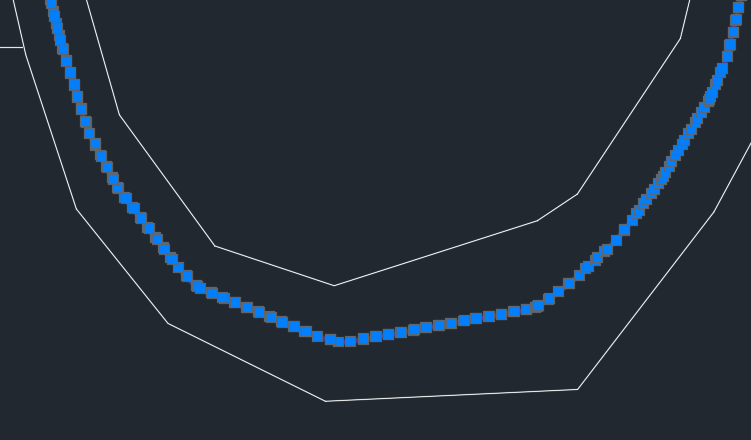

Shapley or geopandas can create this, there’s artifacts though. The algorithm is some sort of Voronoi https://centerline.readthedocs.io/en/latest/# https://gis.stackexchange.com/questions/474810/how-to-get-the-centerline-of-a-polygon-without-artefacts-in-python a bit wonky

I don't think it's possible to obtain a geometrically correct axis with perpendiculars. Try doing the same thing manually, but with bisectors for each vertex of the two polylines. Extend each bisector to the other polyline and use the midpoints as points for the axis.
