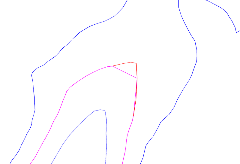

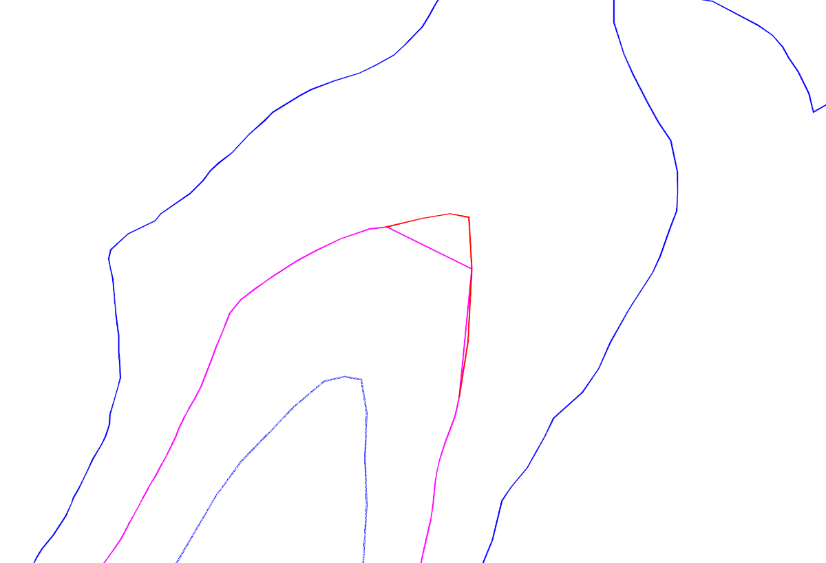

I tested the code. All the points are equidistant, but there are two long segments where the equidistance is drastically broken. In the last screenshot Dexus attached, you can see approximately where the center line should be in that area. The center line returned by the GLAVCVS code is shown in magenta. And the approximate location where it should be is shown in red. I've attached an image of this

Attempt number 2: This code is intended to always return a centerline whose points are all perfectly equidistant from the margins. This should happen in all cases where two LWPOLYLINEs are provided, one for each margin. The case of islands has not been considered yet. The resulting centerline is geometrically dense. This can probably be simplified in a future version. The approach taken in this code has been to obtain points from the normals and the bisectors of each margin, which are then combined at the end to build a list of points. Therefore, it is a fragmentary and massive approach. For this reason, the code is not very fast. However, there is another, more elegant approach, based on dynamically relating the geometry of both margins. It is more complex, but it would also be faster, and the error margins would be “bridgable”. If this thread has enough life in it, I may feel sufficiently motivated to finish it. That’s all for now. ;|*********************** CENTER-LINE ************************* ************************ G L A V C V S ************************* ************************** F E C I T *************************** |; (defun c:CLG (/ PI/2 lst e1 e2 l1 l2 lp lp1 lp2 p0 p> p< r1? x m a tol autoInt? ordenaPts interCpta ptEqd) (defun autoInt? (l lp / p0 p1 p2);autointersecci贸n? (if l (setq p1 (polar (car l) (setq a (angle (car l) (cadr l))) 0.001) p2 (polar (cadr l) (+ a PI) 0.001) x (if (not (vl-some '(lambda (p) (if p0 (inters p0 (setq p0 p) p1 p2) (not (setq p0 p)))) lp)) l) ) ) ) (defun ordenaPts (lst / pIni dm d ps? ps lr); puntos en orden (setq pIni (mapcar '(lambda (a b) (/ (+ a b) 2.0)) (car lp1) (car lp2))) (while lst (foreach p lst (if (and dm (/= (min (setq d (distance (if ps ps pIni) p)) dm) dm)) (setq dm d ps? p) (if (not dm) (setq dm (distance (if ps ps pIni) p) ps? p)) ) ) (setq ps ps? ps? nil dm nil lst (vl-remove ps lst) lr (cons (cadr ps) (cons (car ps) lr))) ) lr ) (defun interCpta (pM p1 p2 lp / i? i1 i2 d a b); captura de los m谩rgenes (defun i? (pA pB lp / p0 i dm is a) (foreach p lp (if p0 (if (setq i (inters p0 (setq p0 p) pA pB)) (if (and dm (/= (min (setq d (distance pM i)) dm) dm)) (setq dm d is i) (if (not dm) (setq dm (distance pm i) is i)) ) ) ) (setq p0 p) ) (if is (list (car is) (cadr is) 0.0)) ) (if (and (setq a (i? p1 p2 lp1)) (setq b (i? p1 p2 lp2))) (list a b) ) ) (defun ptEqd (A B e1 e2 / eqDist-f t0 t1 f0 f1 tm fm n i v+- v*); captura punto equidistante (defun v+- (o a b) (mapcar o a b)) (defun v* (p s) (mapcar '(lambda (x) (* x s)) p)) (defun eqDist-f (ds A B e1 e2 / pt d1 d2) (setq pt (v+- '+ A (v* (v+- '- B A) ds)); Punto sobre AB: P(ds) = A + ds (B - A) d1 (distance pt (vlax-curve-getClosestPointTo e1 pt)) d2 (distance pt (vlax-curve-getClosestPointTo e2 pt)) ) (- d1 d2) ) (setq t0 0.0 t1 1.0) (while (and (< (setq n (if n (1+ n) 0)) 100) (> (- t1 t0) 1e-6));m茅todo de bisecci贸n (setq tm (/ (+ t0 t1) 2.0) fm (eqDist-f tm A B e1 e2) ) (if (< (abs fm) 1e-9) (setq n 100 t1 tm t0 tm) (if (< (* (if f0 f0 (eqDist-f t0 A B e1 e2)) fm) 0.0) (setq t1 tm f1 fm) (setq t0 tm f0 fm) ) ) ) (if (< t1 1.0) ; par谩metro final y punto equidistante (v+- '+ A (v* (v+- '- B A) (/ (+ t0 t1) 2.0))) ) ) (if (and (setq e1 (car (entsel "\nSelect FIRST LWPolyline..."))) (= (cdr (assoc 0 (setq l1 (entget e1)))) "LWPOLYLINE") ) (if (and (setq e2 (car (entsel "\nSelect SECOND LWPolyline..."))) (= (cdr (assoc 0 (setq l2 (entget e2)))) "LWPOLYLINE") ) (progn (foreach l l1 (if (= (car l) 10) (setq lp1 (cons (cdr l) lp1)))) (foreach l l2 (if (= (car l) 10) (setq lp2 (cons (cdr l) lp2)))) (setq r1? (> (distance (car lp1) (car lp2)) (distance (car lp1) (last lp2)))) (setq tol 0.01 PI/2 (/ PI 2.) lp1 (if r1? (reverse lp1) lp1)) (foreach e (list e1 e2) (setq p0 nil m nil r? (if (equal e e1) r1?) lp (if (equal e e1) lp2 lp1)) (while (setq p (vlax-curve-getPointAtParam e (setq m (if m ((if r? 1- 1+) m) (if r? (vlax-curve-getEndParam e) 0))))) (if p0 (progn (setq lAB (autoInt? (interCpta p (polar p (setq a (+ (angle p0 p) PI/2)) 10000) (polar p (+ a PI) 10000) lp) (if (equal e e1) lp1 lp2));NORMAL AL COMIENZO DEL SEGMENTO lst (if lAB (cons (ptEqd (car lAB) (cadr lAB) e1 e2) lst) lst) ) (if (setq p> (vlax-curve-getPointAtParam e ((if r? 1- 1+) m))) (setq lAB (autoInt? (interCpta p (polar p (setq a (/ (+ (angle p p0) (angle p p>)) 2.)) 10000) (polar p (+ a PI) 10000) lp) (if (equal e e1) lp1 lp2)) ; Bisectriz lst (if lAB (cons (ptEqd (car lAB) (cadr lAB) e1 e2) lst) lst) lAB (autoInt? (interCpta p (polar p (setq a (+ (angle p p>) PI/2)) 10000) (polar p (+ a PI) 10000) lp) (if (equal e e1) lp1 lp2));NORMAL AL FINAL DEL SEGMENTO lst (if lAB (cons (ptEqd (car lAB) (cadr lAB) e1 e2) lst) lst) ) ) (setq p< p0 p0 p) ) (if (setq p> (vlax-curve-getPointAtParam e ((if r? 1- 1+) m))) (setq lAB (autoInt? (interCpta p (polar (setq p0 p) (setq a (+ (angle p0 p>) PI/2)) 10000) (polar p0 (+ a PI) 10000) lp) (if (equal e e1) lp1 lp2)) lst (if lAB (cons (ptEqd (car lAB) (cadr lAB) e1 e2) lst) lst) ) ) ) ) ) (vla-AddLightWeightPolyline (vla-get-modelspace (vla-get-activedocument (vlax-get-acad-object))) (vlax-Make-Variant (vlax-SafeArray-Fill (vlax-Make-SafeArray 5 (cons 0 (- (length (setq lst (reverse (ordenaPts lst)))) 1))) lst)) ) ) ) ) (princ) )

Obviously, this has now become something more than just the search for a solution to a single user’s problem. First of all, I should say that I myself was also reluctant to accept the concept of equidistance advocated by @GP_ and @dexus For the simple reason that applying this principle forced me to accept that the centerline should be the same in these two drawings. Equidistance requires ignoring those areas of the margins that do not geometrically affect the axis. This, which initially caused me some resistance, I eventually came to accept conceptually when I realized that it could serve as a criterion for defining what is a “recodo/inlet” and what is not. So I have abandoned my previous approach and adapted it to this new situation. Having made this clarification, I must say that this concept of equidistance makes the calculation of a centerline more feasible. I’ve been running some tests with Dexus’s latest code, which is the best so far. However, I’ve discovered some “holes” that I hadn’t noticed before. I’m attaching a few images showing this. In my view, these are conceptual errors rather than geometric limitations. And what can we consider “geometric limitations”? I believe that, in any case, every vertex of the centerline must be equidistant from both margins. If this is not the case, the result is not correct. However, the intermediate regions along each segment may be subject to geometric limitations depending on the desired precision. Therefore, in bends or turns, the points taken within the adjustment or “problematic” segments may deviate (within a tolerance) from strict equidistance. The goal, therefore (in my opinion), should be to achieve equidistance at every vertex and to remain within a tolerance in the intermediate zone of each segment. After everything written here so far, some might wonder: is it really possible to obtain a centerline that meets these requirements? As far as I’m concerned, I’m running some tests. GusanoAcad.mp4 I’ll post something over the weekend

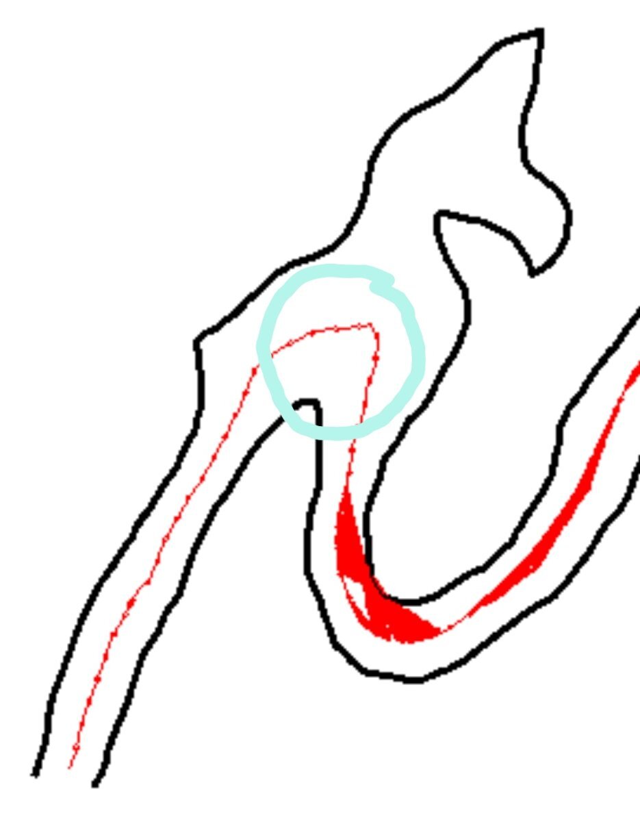

In general, we work with plans for projects of various kinds: engineering, cadastral mapping, and so on. Sometimes we submit proposals for public tenders, but so far without success. @dexus, the performance of your code looks different in that last drawing compared to what I’m seeing on my end. In any case, I think this topic has now entered the realm of a real challenge. @BIGAL: I agree. I think that’s the correct way to draw the centerline in the inlets.
