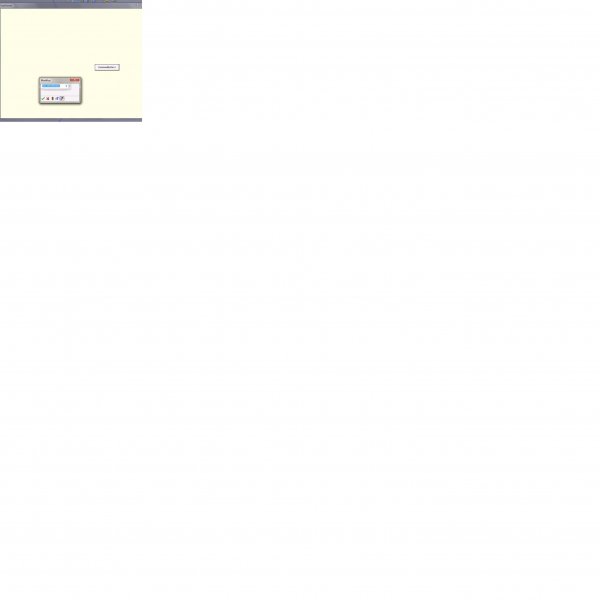

Guest Posted June 12, 2008 Posted June 12, 2008 From time to time I am required to dimension 3-D objects as an x-ref to show people. To print out the drawings I need to have the viewports set to hidden. When I do this, my dimension styles change. (See attached image) The top dimension is inside the view port, set to hidden, and the lower dimension is in paperspace. The bottom dimension is proper. The upper dimension text is bold, and my arrow is outlined. Is there any way to fix this, or do I need to just dimension in paperspace? Quote

hellnback Posted June 17, 2008 Posted June 17, 2008 The problem is that the arrow in your dim is a solid, so it hides it. It also hides solid hatching and true type fonts but I'm sure there is a setting somewhere to get the text to plot correctly but not sure on the arrows. Quote
Guest Posted June 17, 2008 Posted June 17, 2008 i would dimension in paper space That works, was just wondering if there was a way around it. Quote
