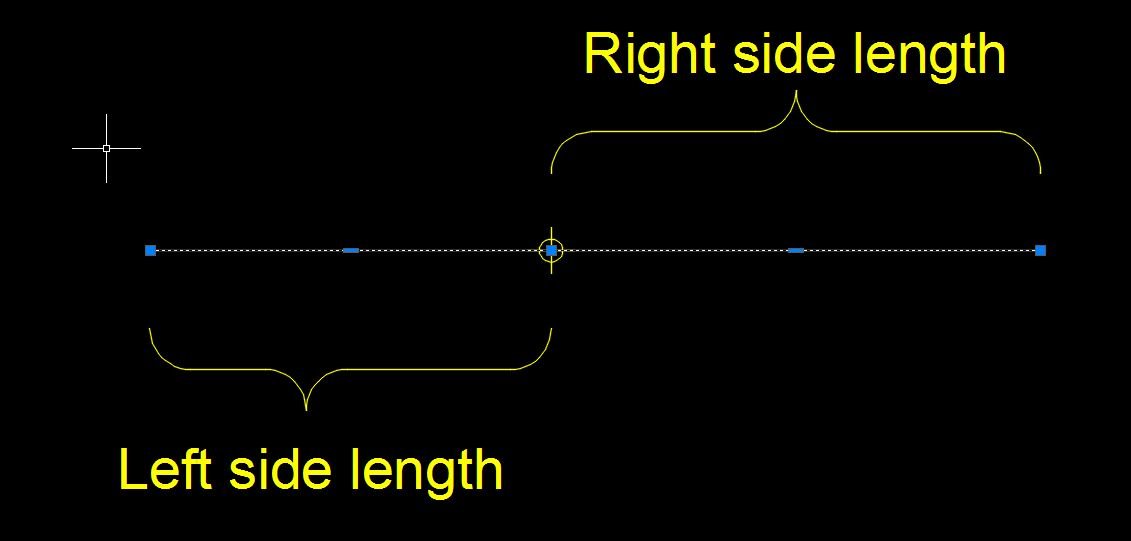

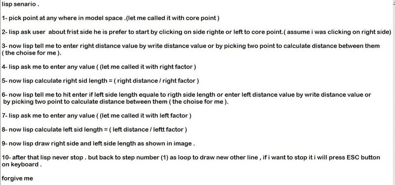

draw left and right line segment from point
Abdulellah posted a topic in AutoLISP, Visual LISP & DCL
i am sorry i need this lisp urgently , i have heavy work in my job or i fail lisp senario attached below . i hope some body help me . this is my final requier , please there is an lisp file can draw equal line parts of line midell point , can make modify to get newest lisp have required sinario سيناريو رسم خط من جهتين.txt line from midpoint.lsp
