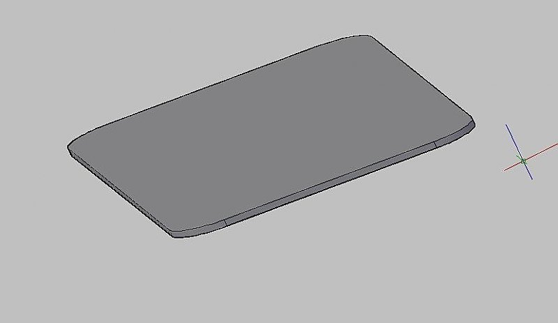

Quick question. Does anyone know if arcs or curves can slice a solid? I have tried using the regular way but it's not working. Maybe cause my solid is at an angle or not. If anyone knows of a way please send some instructions on how to do it.

they can, but with your file there i would extrude your profile down through your box. then use the intersect command. INTERSECT will give you this. Becuase your profile is closed, when you try to create a surface, you get a solid. If you are set on slicing the object you will need to create some lines that can be swept or lofted to create a surface, then use this as a slicing plane.

It work just as you specified. The only thing is that i need the other piece. the one that gets deleted when i use intersect. Is the a way to get it done so that i can keep the piece that gets deleted.
Copy before you do anything. You might want to go through the tutorials in my signature.

Matt i worked it out with subrtact and it worked, then i just changed my ucs view and sliced some edges and got it. Thanks for your help.

you got it, subtract is the way to go if you wanted the outside. Also keep in mind that when you use the extrude command it will extrude perpendicular to your profile. If you want something different you can draw a line for your path and either Extrude>Path, or sweep and then use the Subtract command.
