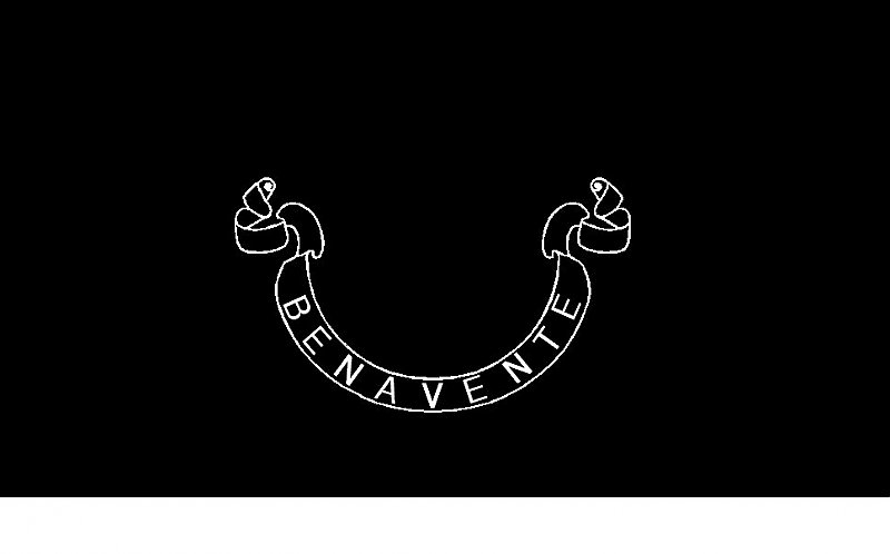

I got my project back today echr said it was GOOD but not great. Got a "B" these because the said that th elettering insaid the banner has to be all algiend , and have the same spacing between them, i used for text hight 0,200 and it with is the stanterd " 0,02 "
Could someone show me or explain me, what i should have done to algin the text and space them equal thru out the banner,, keeping in mind that the letter " V " has to be in the center of the banner .
autonaticaly i left these letter with angel "0" ... rest i did with rotate and move ,, until i thought it was ok,..
Could someone show me or explain me, what i should have done for it to be correct. The scale im using is 1\20.

we do have a few threads already on how to ALIGN TEXT to an ARC, and how to use such commands as DIVIDE to ensure equal spacing
put one or two of those words into the search facility and I'm sure you'll find what you need :)
btw - it is a mortal sin to 'eye in' anything with AutoCAD - the whole principle is to be accurate :wink:
I've changed the title of your thread, as the keywords drive the 'linked threads' at the bottom of the page. Scroll down and you should now find something useful :thumbsup:

thank guys got it to work with express-text-arc
