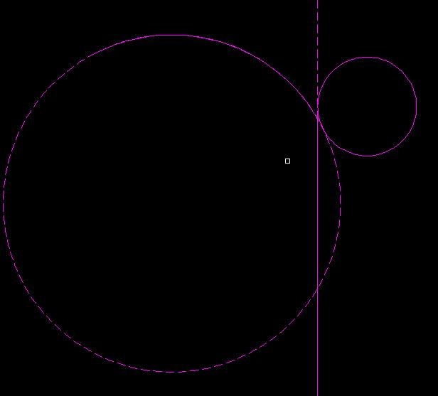

This does work most of the time, but every once in a while it creates the circle on the wrong side, cause there's technically two circles possible that are tanget between a line and an arc... just depends on which one AutoCAD decides to make. Attached is an example of what I'm talking about... I wanted a 6" circle on the inside of the bigger circle, but no matter what order I selected the objects/points I couldn't get AutoCAD to make the correct circle.
