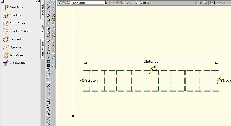

I'm trying to create a dynamic block for a ladder which I would like to be able to stretch left and right, with the rungs arraying as soon as the stretch reaches a certain distance (270mm).
I've attached a screenshot of what I mean. Any ideas if this is possible?
you are almost there. The exclaimation mark is because you haven't associated the array action with a parameter - in this case distance.
I would do it slightly differently to you though. I would only put one distance grip so that I could just stretch it upwards rather than for either end.
Thanks dbroada,
I've sussed it out now! I just needed to change the way I thought the array worked (as it normally does!) for some reason I thought it would work different!
I've also taken your advice and used 1 grip point on the linear.
Many thanks! (and thanks for not spoon feeding me, made me think!)
