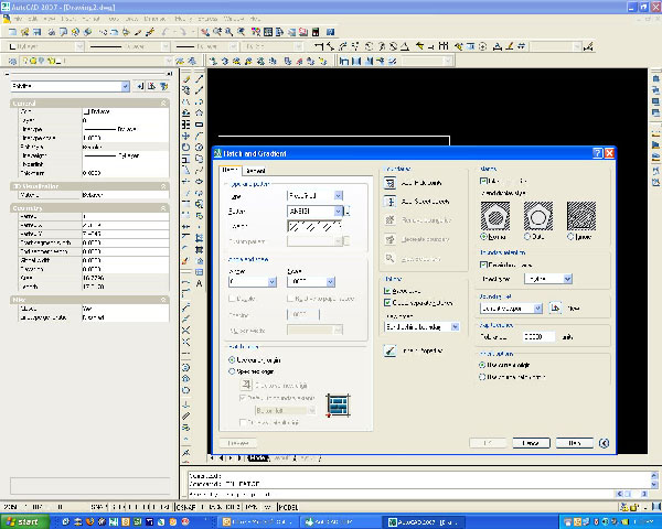

BStreiss Posted January 26, 2008 Posted January 26, 2008 I've been using Autocad 2007 for the past 5 months without these issues, then I had to create a new account on my computer at work and now EVERY time I create a hatch it turns into this dead mass. Yes, I've tried creating an associative hatch, and no, I can't edit them either. Any ideas would greatly help. Quote

BStreiss Posted January 29, 2008 Author Posted January 29, 2008 As promised, here is a sample file from work. After I created the hatch I tried to edit it on my machine without any luck. My office mate had success, though we made a copy of the file just to be sure she didn't muck up the results. I've also attached a screen shot my my screen moments before I clicked ok to exit from the hatch. Any idea welcome. Thanks for everything. Hatch Sample.dwg Quote
Cad64 Posted January 29, 2008 Posted January 29, 2008 Works fine on my machine. Since the problem seems to be isolated to your machine, I think maybe you should try what Mahahaavaaha suggested and run a repair on your installation or uninstall and re-install the program. Quote
BStreiss Posted February 15, 2008 Author Posted February 15, 2008 Problem solved! It happened that the pickstyle variable had gotten set to 2. I changed it to 1 and problem solved. Quote
