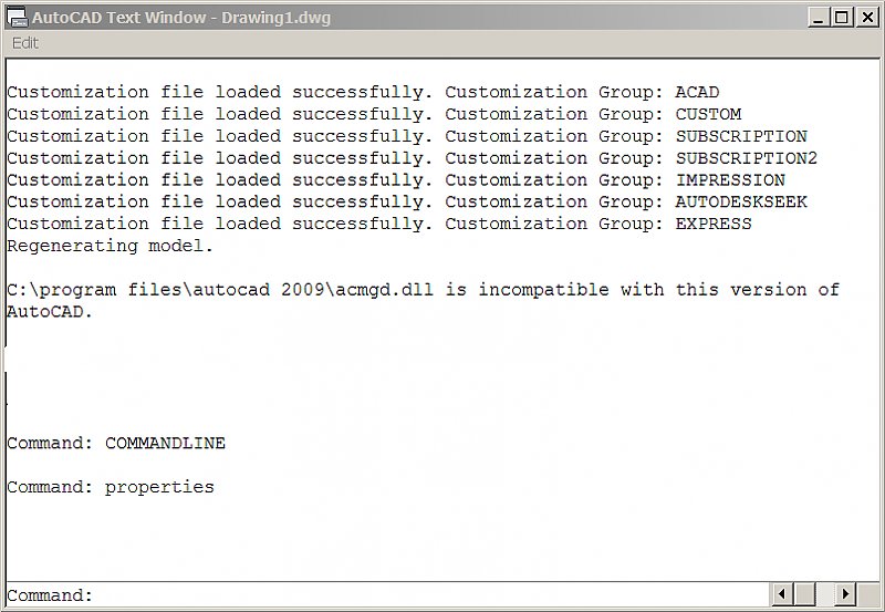

Error occured when opening AC2010. I've just installed it just two days ago.
Any ideas, what is this mean? or How to solve this?
Thank you.
This appeared during the initialization of AutoCAD, or after?
It happened after.
It was fine during initialization, no error and used it throughout the day.
Next morning; turning it on, an error showed up.
When I open AC2010 and hit F2; I found this:
So I check; Tools -> Options -> Files -> SupportFile Search Path, and found AC2009 was still in there.
I guess when during installation and migrating all files this were never removed.
When I removed it, the error disappeared. Problem solved.
Good luck with AC2010.
Thank you for the update.
