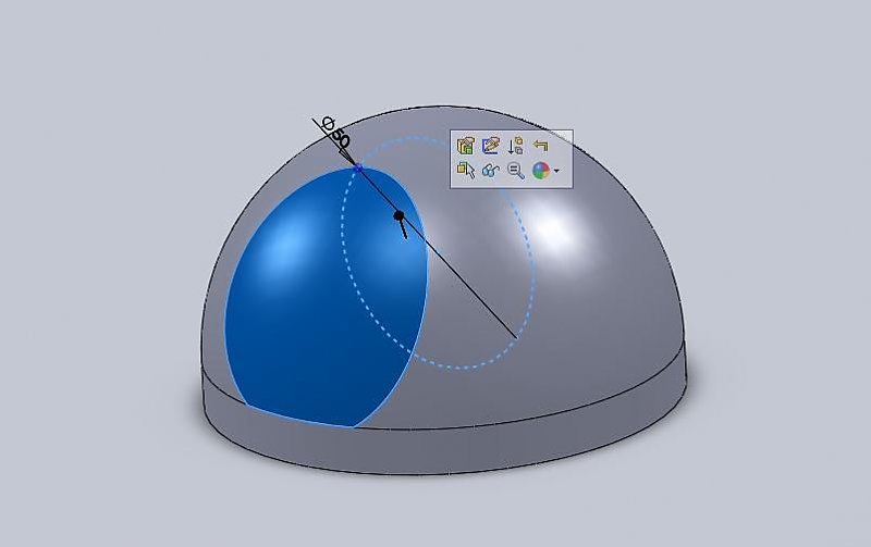

joes Posted May 7, 2009 Posted May 7, 2009 Hi Still struggling a bit with simulation studies in solidworks. As in my last post (Materials) I have a dome structure that I want to apply a pressure to. I dont want this to be uniformly distributed as it has to simulate wind pressure at a certain point. so my questions are: - 1. How can I apply a pressure to one area (do i have to sketch the area on the part first) 2. I want to create a mesh for the dome with the mesh being 'fine' around the areas most likely to be effected by the stress and 'coarse' around the other areas. Not sure how to do this. Again any help would be appreciated Thanks Quote

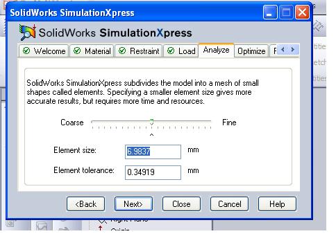

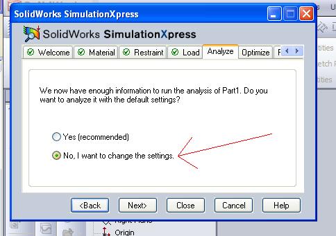

shift1313 Posted May 7, 2009 Posted May 7, 2009 Which version are you running? If you are running SimulationExpress you are able to make changes to mesh but its for the entire part and not one area. 1. The feature "Split Line" is what you want to look into. You can use the split line tool to create divisions on your part making selectable faces of the part rather than the whole part. In your case a projection split line will probably be the best, you will need to create a line or sketch that would be perpendicular to the direction of force and use the projected split line. Ive uploaded an image where you can see the sketch(dashed line) and the projected split plane on one face which is now selected(so you can see it better). This face would now be selectable in an analysis and you would use the plane as a reference for direction. (note: setting your load as a pressure will assume the force is perpendicular to the face so in this case on a dome you would not be accurately modeling this, plane reference for force direction is only available with force and not pressure). For your split line i would just draw a single line in your top plane that bisects the dome and project this as a split line. It will "split" your dome in half. 2. the second and third screen shot show you some simXpress windows. when you are prompted to run with default settings you need to click no, this is how you change the mesh size with simXpress. If you are dealing with the full version of the simulation and flow software you can do aero studies where you put the entire mast assembly in a wind environment and it can spit out an FEA model. I do not have this nor have i used it so if thats what you have i cant help. I suggest you go to your help menu, Solidworks tutorials, then click on design analysis and simulationxpress. This will give you the basics. I have seen tutorials on simulations online but i dont remember where that was, ill have to dig for it. edit, didnt have to dig that far: http://www.solidworksmedia.com/SimulationXpress/index.html Quote
joes Posted May 7, 2009 Author Posted May 7, 2009 Thanks again that was really helpful. I have managed to sketch an area and project it on to the face of the dome. My version of simulation does seem to be a little different though, i have come across a way to generate the mesh with something called mesh controls. I have not run the study yet but hopefully it will be a step in the right direction. Thanks for your help! Quote

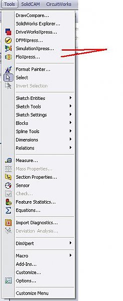

shift1313 Posted May 7, 2009 Posted May 7, 2009 hmm, when you drop down your tools menu, what do you click on to start your simulation(or do you have the sim toolbar open?) Because i have the 1st level i have flowXpress and simXpress. Quote
joes Posted May 8, 2009 Author Posted May 8, 2009 Yes when i drop the tools menu down i have found floXpress. I have had a quick look at it and it does not look as though i can apply a wind pressure externally to the object. I'll see if i can find any tutorials on it and try and work it out. Thanks for your continued help. Quote
