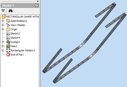

I want to make holes (for bolt connections) along the shape created by sweep feature (the file on attachment). I have already tried several ways to do it but always failed. One of ways is to create a hole first then applying rectangular pattern using sweep line as the path. This way did not work.
I would really appreciate if any of you could help me find/share the easiest way to do it.

Because you didn't include a hole and a pattern in your attached file - it is not possible to determine your design intent.

Mr. Mather,
Now, I understand to your request.
Please see the drawing on attachment and please let me know:
-did I do "rectangular pattern" correctly?
-why do the holes on the radius area do not go through the thickness of plate.
Let me have your advices.

But I do not specifically understand against what you meant with "didn't include a pattern".
Because there was no hole and no pattern - I don't know what size, where to start and how many holes you want (it wouldn't matter if the pattern was wrong - at least then I would be able to tell you exactly what you were doing wrong).
Third, it came to my notice that it is only 1 hole on radius area.
You didn't include all information - so how was I supposed to know how many holes you wanted?

On attachment you could find the drawing of the part (including holes and rectangular pattern). The name of product is fabric expansion joint.
Here are some questions:
-please let me know what is wrong with the making of that part?
-take a close look on the radius area, why do those holes not in full circle?
-for holes, the number of holes and spacing could be various. They depend on the size of flange/plate. So, for example, let us take the number of holes are 50 pcs with spacing 50 mm.
Hope the above covers all information you need. If not, please let me know.
Now, what I want is step-by-step instructions in Inventor to make holes along the length of flange/plate. The number of holes, spacing between holes, the length of flange/plate could be various.
