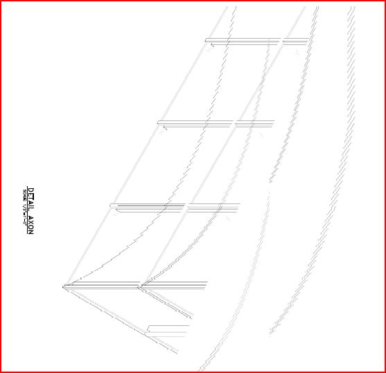

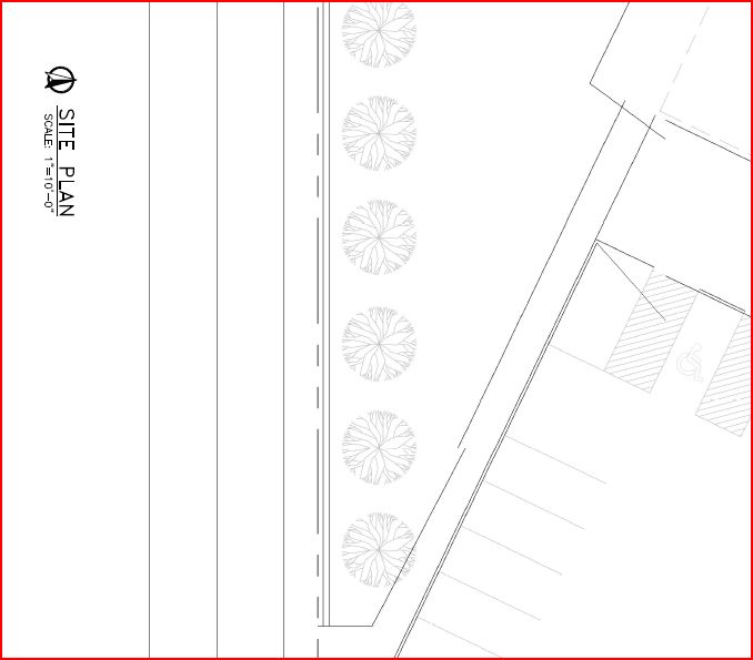

Jay C Posted May 7, 2009 Posted May 7, 2009 I have my sheets set up in viewports, when i plot to pdf on 24x36 all my lines become distorted, sometimes they don't even touch. if i plot to pdf in model space it works fine, but my sheets are already set up in paper and don't feel like changing them. Thanks Quote

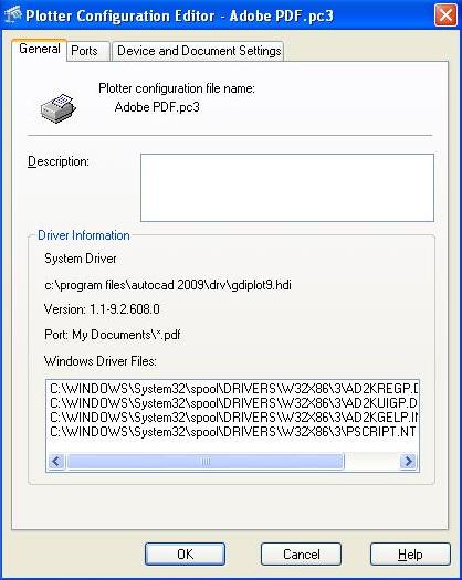

The Buzzard Posted May 12, 2009 Posted May 12, 2009 I am using Acrobat 6.0 Standard, But the plotter is setup as Adobe PDF Converter - Windows System Driver - by Autodesk and the driver name is Adobe PDF.pc3. When you click on the Properties button and get the Plotter Configuration Editor you can select Custom Properties, This will bring up Adobe PDF Document Properties dialog. Go to the Layout Tab and you can setup the sheet orientation. There is an Advanced button, When selected you can choose your paper size. I select PostScript Custom Page Size and can enter the units in inches or millimeters. After all settings are made you can apply them to the current plot or save them to a file. Under your plot settings make sure you select PostScript Custom Page Size for your paper size. I beleive you can configure the Adobe PDF.pc3 in the Plotter Manager. After the plot is completed your pdf always looks correct in the proper reading direction vs the regular Adobe PDF driver. I think this would be good for you to look into. Quote
The Buzzard Posted May 12, 2009 Posted May 12, 2009 Here is a look at the driver information on the 2009 Plot driver for Adobe PDF.pc3 Quote
Jay C Posted May 12, 2009 Author Posted May 12, 2009 I am using Acrobat 6.0 Standard, But the plotter is setup as Adobe PDF Converter - Windows System Driver - by Autodesk and the driver name is Adobe PDF.pc3. When you click on the Properties button and get the Plotter Configuration Editor you can select Custom Properties, This will bring up Adobe PDF Document Properties dialog. Go to the Layout Tab and you can setup the sheet orientation. There is an Advanced button, When selected you can choose your paper size. I select PostScript Custom Page Size and can enter the units in inches or millimeters. After all settings are made you can apply them to the current plot or save them to a file. Under your plot settings make sure you select PostScript Custom Page Size for your paper size. I beleive you can configure the Adobe PDF.pc3 in the Plotter Manager. After the plot is completed your pdf always looks correct in the proper reading direction vs the regular Adobe PDF driver. I think this would be good for you to look into. i think were talking about 2 different things, the images are distorted because the lines on the first one are curved and jagged and on the second image they don't even touch. the only reason they were rotated was because i had 3 sheets in portrait adn 3 in landscape and i didn't change the orientation Quote
