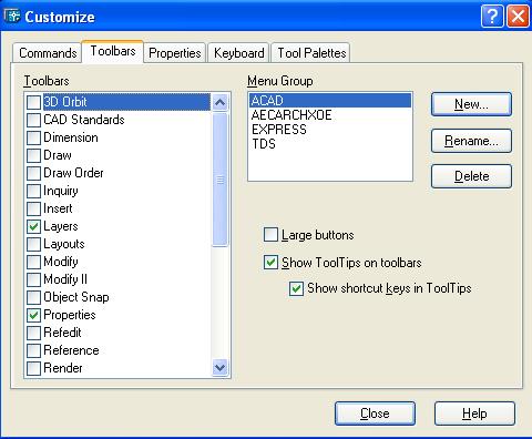

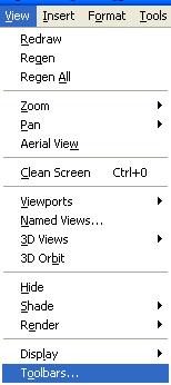

Under the View popup menu go to Toolbars and check the toolbar you wish to display.
Here are the dialogs for you to view.
Not sure which version you are using, But this is from 2009.

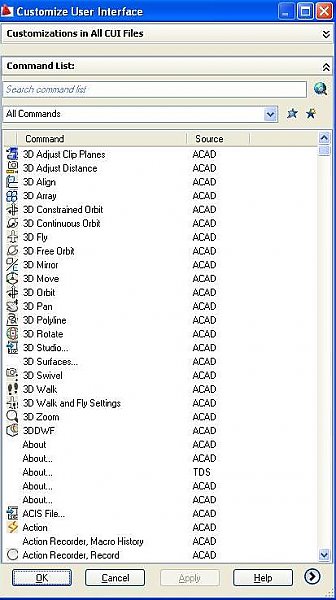

In 2008, I don't get that customize dialogue box when clicking toolbars from the view menu - it goes straight to the customize user interface dialogue box. Although, I noticed that it's possible to set the workspace here also.
