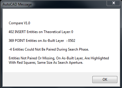

On 12/11/2015 at 3:22 PM, ymg3 said:
thiof,
Here I've cleaned up the code and added up a few "Bells and Whistles",
however you need Express Tools installed for the progress bar to be
operationnal and the program to run.
The Red Circles have been replaced by Red Squares of the same size
as the Search Aperture.
Blocks have prefix name "Compare", the layers are now "Compare_Tags"
and "Compare_Values"
A little report is given in the Alert Box at end of processing. Notes in the example
below the negative number on paired entities. Probably means that some
of the points are duplicated.
So Enjoy!
ymg

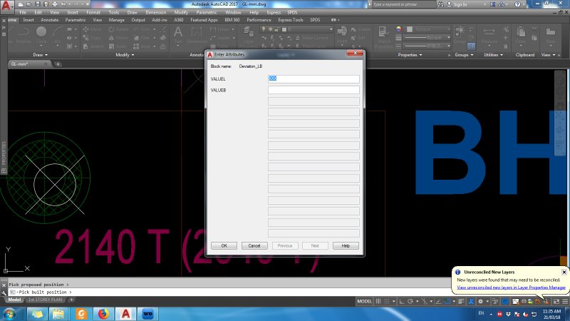

YMG,
This is a very usefule routine.  Can it be modified to use my block? I do survey as-built drawings for anchor bolts.  About half of the drawings I do are not rotated true north (for presentation of final asbuilt).  I also show 2 decimal places in decimal feet. Drawing file attached.  Check paper space for notes. "tolerance" block is already inserted in my drawing. Please let me know if you can help.
Thanks!
