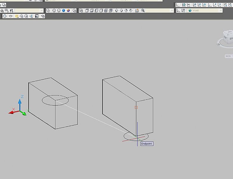

cadboi08 Posted May 17, 2009 Posted May 17, 2009 Hey When tracing 3D objects in say a side view, how can you make it just snap to the points rather than on a 2D plane? Quote
totzky Posted May 17, 2009 Posted May 17, 2009 Hey When tracing 3D objects in say a side view, how can you make it just snap to the points rather than on a 2D plane? By adjusting your ucs to that view? Quote
cadboi08 Posted May 17, 2009 Author Posted May 17, 2009 I mean, I have 3D objects in model space. I'm trying to snap from one point to another but it snaps along the UCS plane, creating a 2D polyline in the end. I just want to be able to draw a polyline from a few of these endpoints (the two circled for starters) and then some others across the x/y/z planes. Quote
Cad64 Posted May 17, 2009 Posted May 17, 2009 If you draw with a LINE or a POLYLINE, then yes, you will be restricted to your current XY plane. Try drawing with the 3DPOLYLINE. Quote
cadboi08 Posted May 17, 2009 Author Posted May 17, 2009 If you draw with a LINE or a POLYLINE, then yes, you will be restricted to your current XY plane. Try drawing with the 3DPOLYLINE. Thank you very much. Didn't even know that existed Quote
