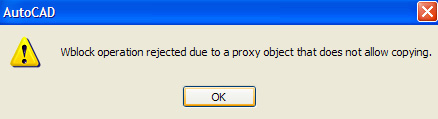

Wblock operation rejected due to a proxy object that does nota allow copying
Hi, is anybody can help on how to fix this problem.
Everytime i WBLOCK the drawing it says the message in the dialogue box:
also, whenever i BIND the sheeting drawing that contain that particular drawing xref, it can't be bound.....the error says:
Error: At least one of the specified xrefs failed to bind due to a problem with a proxy object.
can anybody help with this? :( thanks in advance.

My guess is that the drawing was done in a vertical of AutoCAD, with an application to AutoCAD or a later version of AutoCAD.
If you go to QSELECT - do you have Proxy Objects in the list there? see if you can select them and delete them, perhaps thaw and On all layers first.
Purge and Audit is always a good idea.
Another idea, that might take a while though - is to use QSELECT to select objects one object-type at a time and move them to a new drawing, then discard the old one.
