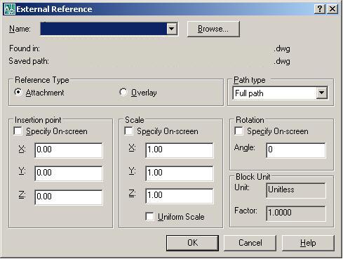

My collegue comes across this problem: the drawing itself is "oke" but when this very drawing is xref'ed to another drawing it scales up 25.4 times. So the xref must be manually scaled down 1/25.5 (=0,03937007874015748031496062992126) and it works again.
The factor 25.4 must be the inch / mm relation I guess...
But wher does this go wrong?
Is it a systemvariable that is not set right on his computer? Or is there another explanation? I'm quite aware of the program Acad2007 but this one I can't explain.
Thanks for the help!
Oh yeah... it is not allways this way, just this very drawing and maybe 1 or 2 others... The rest is no prob.
check this options>user preference>insertion scale> source content unit & target drawing units.

Checked it and both are "millimeters".
My guess is that "once there was a drawing" that was set up by an architect in inches. Instead of fixing the problem we have done the thing with scale / rescale and so on.
This particular drawng was then copied to another project because of its contents, like dimscales, plotter propperties, and most iportant several layouts.
When copied all is copied, also the "bad" measurements...
AT ONCE I HAD AN IDEA !!!
Check the images below (wiped out our customers info):
It has to do with Block Units, it should be at all times unitless and factor 1 for we work only in mm. But I can't alter it in that specific dialog box. So I wonder, is this a drawingspecific unit? And if Yes, where to modify the whole thing.
I am very close !!8) A little help...
That Thing U Can Chnage
Type 'insunits' At Command Line & Change It To 4 For Mm

Is the insunts variable drawingspecific ?
If Yes then I wil make a new function wich will be applied when starting up acad: (setvar "insunits" 4). Of course it must be saved then, but okay.
In that case I can be shure it is always correct.
The "once there was a drawing" is a common problem...I tell my collegues over and over again never to use a drawing from the client, always always always start a new one using the template and insert/xref the clients drawing into it. A wonder how many problems can be avoided that way.
Just saying you're not alone :)
and yep, INSUNITS is drawingspecific.
