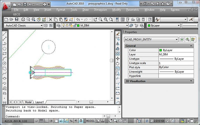

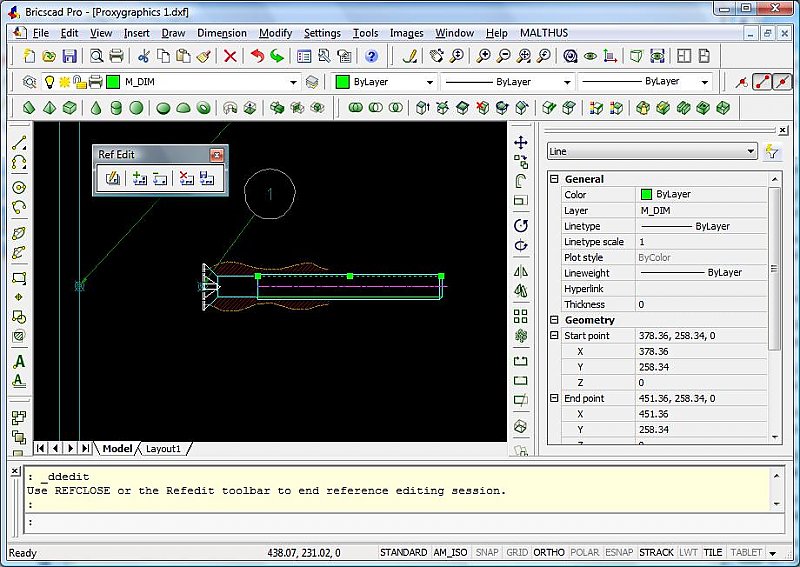

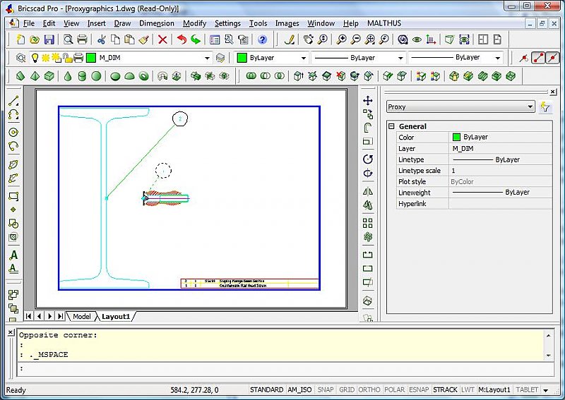

Raggi_Thor Posted May 20, 2009 Author Posted May 20, 2009 Thanks, that was great. I think it looks OK in Bricscad, but I can't edit the proxy objects, and that is good. If I save as R12 the proxies are converted to normal blocks that can be edited. Quote

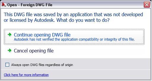

Raggi_Thor Posted May 20, 2009 Author Posted May 20, 2009 While I have your attention I just moved the objects around, added an metxt and saved in Bricscad. Does it still work OK in Mechanical? Proxygraphics 1 saved by Bricscad.dwg Quote
Raggi_Thor Posted May 20, 2009 Author Posted May 20, 2009 Btw, It looks exactly the same in AutoCAD 2010. Maybe I need to install some Object Enablers to edit the parts list etc? Anyway, thanks again for the file. Quote
GE13579 Posted May 20, 2009 Posted May 20, 2009 Hi Raggi, It works fine after you've moved it around, just that ACAD gives the warning on opening that it's been created in a non Autodesk product. I'm not sure what you mean by Object Enablers?.. Quote
