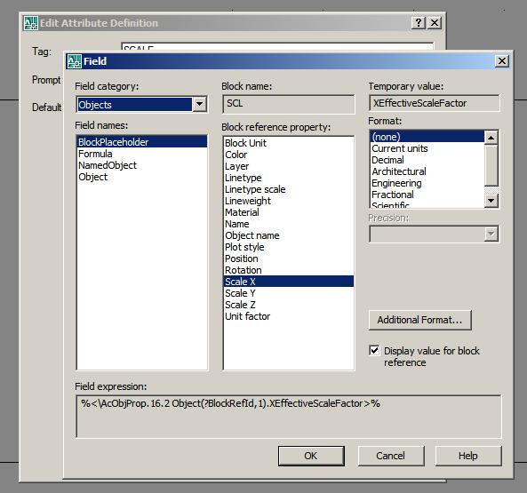

I have a block I wish to create. Inside the block I would like txt that will show the Scale of the block is this possible. I think it is but just cant think of how to do it.

Yes, if someone inserts the block at a scale of 5 it would be reflected in the text. I can not use a LISP, that would make it to easy (wish I could).

you can use a field to report the scale. Do a search here for fields to find exmples.

I don't have AutoCAD here so can't experiment and don't have time to look at work tomorrow but when defining your ATTRIBUTE, right click to enter the field dialogue. Look through ALL the options and there is one for object scale. I know it is available as I have used it in formulae in dynamic blocks but I haven't used it to directly report the scale.

this has to be done within the BEDIT screen. Add your ATTDEF and insert field in the default box. Add field as indicated in the screen shot. DONOT OVERTYPE THE DEFAULT!!!! After you change the scale of the block you will need to regen.
