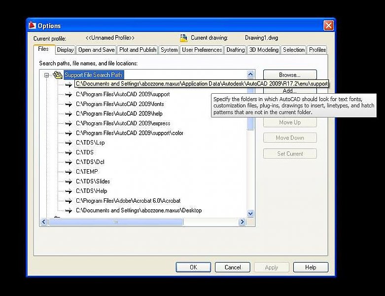

dtkell Posted May 20, 2009 Posted May 20, 2009 You can use this lisp to align text to a specific x or y coordinate. textalign.lsp Quote
AQucsaiJr Posted May 20, 2009 Author Posted May 20, 2009 does this .lsp work with ACAD-E 09? I can not seem to get it to work. I loaded it through the Tools>AutoLSP>LoadAplication and it does not seem to be able to activate the command within ACAD-E. I keep getting the Unknown Comand error. Quote
The Buzzard Posted May 20, 2009 Posted May 20, 2009 I am using ACAD 2004 & 2009 and it works fine. The command syntax is TAH to start the command. Nice program. Quote
AQucsaiJr Posted May 20, 2009 Author Posted May 20, 2009 Thats wierd... it does not seem to work for me... Did you load it the same way I did? Did you make any changes to the file, like rename it or anything? Quote
AQucsaiJr Posted May 20, 2009 Author Posted May 20, 2009 seems as though I lied... I guess I needed to close out of ACAD and re-open to get it to work... I'll check it out.. thanks Quote
The Buzzard Posted May 20, 2009 Posted May 20, 2009 Could possibly be a search path problem. I put it on my desktop and desktop is in my search path. And by the way I did load it the same way. Check the search path. Quote
The Buzzard Posted May 20, 2009 Posted May 20, 2009 You set the search path in Options under the Files tab and add the path under Support File Seach Path. This is where the program is located on your drive. Quote
AQucsaiJr Posted May 20, 2009 Author Posted May 20, 2009 Well it seems to be working now... after I closed out and re-opened ACAD-E, so i'll check out this LSP... I do have a question though... How do I check the search path you are referring to? I just know how to load LSP but thats it. Quote
AQucsaiJr Posted May 20, 2009 Author Posted May 20, 2009 got it... Thanks... I'll give it a try. Quote
AQucsaiJr Posted May 20, 2009 Author Posted May 20, 2009 Yep... Cool... I placed the file path in that list... It seems to be working now... Thanks for all the help. Quote
