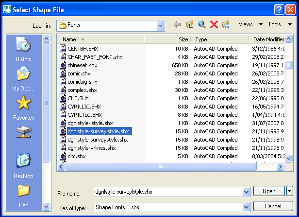

I Just firstly want to apologise as i know that this has already been explained how to fix but i am still having a problem.
When the select shape file box comes up when opening a file, autocad seems to find the shape file but still comes up with the prompt. Im a bit confused as to why.
Apart from purging the shape file out is there another way to fix this.
The shape file originally comes from a microstation drawing if that makes any difference.
Please see image.
Cheers
That dialog is prompting you for a "shape file", not a font. It looks like you are selecting a font from the Fonts directory.
Like R.K. illudes to, there are many kinds of SHX files. Fonts are basicly shapes, but they're not shapes, they're fonts. You've got to pick a shape file, not just an SHX.
Cheers, I did not realise the where different kinds of .shx files
