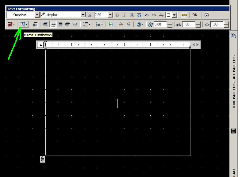

richard3009 Posted May 21, 2009 Author Posted May 21, 2009 Yes i use that button and it gives me midpoint, I have sussed what was wrong when placing the multiline box the default text size is set at 100mm instead of 2.5mm, how do I clear that dropdown list and make 2.5 my default Quote
NBC Posted May 21, 2009 Posted May 21, 2009 When creating the MText, after you have picked the first corner of the rectangle (and BEFORE you click the second corner of the rectangle) enter H at the commandline, and set your text height to your desire. This will then become the default for all future MText creations for that particular drawing. Quote
