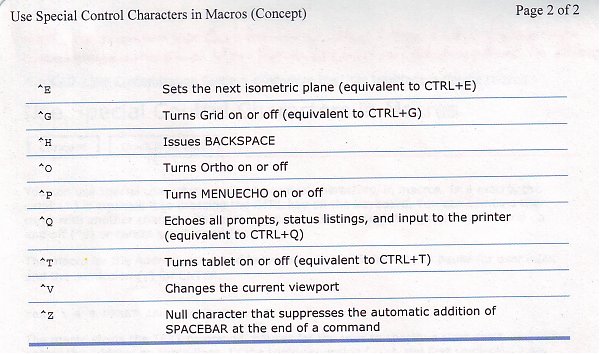

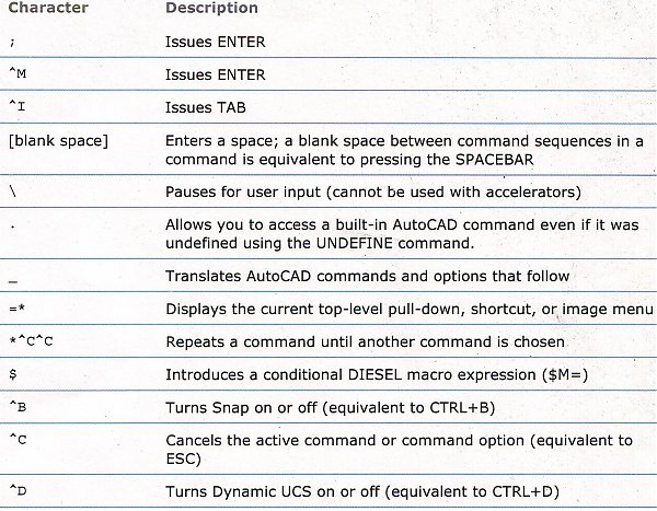

Guest Alan Cullen Posted March 2, 2008 Posted March 2, 2008 Dunno. Maybe ^C^C will do it. I know nothing about macros, and don't profess to know anything about them. I once came across all the macro commands available, and I thought we had that in the FAQ, but a quick search tells me we left that out. I would suggest doing a search in acad help, because that is where I found it all. I know that is not a real good answer, but trust me on this, I found it there. Just use different search terms, like Macro, etc. Quote
Guest Alan Cullen Posted March 2, 2008 Posted March 2, 2008 At the risk of getting howled down by the knowegible members here, I have done a hunt back through my records, and this is the best I could come up with. I think the original search was done in 2008, I only have 2007 here at home, so I scanned what I have. Hope it suits. Quote

diverman241 Posted December 27, 2012 Posted December 27, 2012 The dialog is preset to pop-up in the add-on, so my questions is really about dismissing the dialog once it is open. The dialog is accessible within the menus, so I wont need two macros, just the one that dismisses. I have tried the ^I for tab and ^M for enter in the macros and haven't gotten CAD to process any of these until after the dialog as been addressed. Someone in another forum had mentioned DIESEL macros, but I'm not sure I understand their use in this situation. Quote
