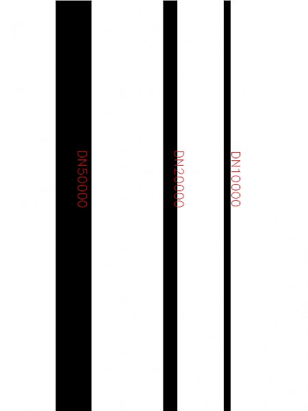

I have a lisp routine that we use in our office for labeling polylines with a global width.
ie if I have a polyline (representing a pipe) that has a global width of 0.2, the routine will label all segments of the polyline with DN200
What I would like to do is to change this code so that if a polyline segment is smaller than 10 units, then this segment does not get a label.
For example, a polyline with a lenght of 29 units has 3 segments, 2 segments have a length of 12 units and a third segment with 5 units.
I want the 2 segements of 12 units to be labeled but not the third segment with 5 units

Was ist wenn Poly breiter ist, dan past das nicht.
Dani,
A picture is worth a 1000 words :)...I reposted the code, give it a try.
